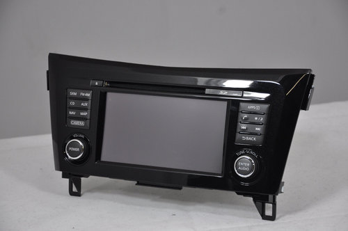

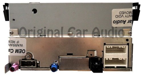

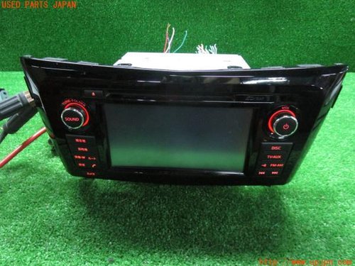

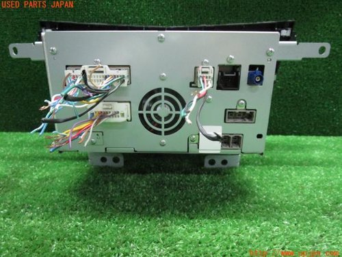

I am buying a JDM spec Xtrail and i think we all agree that the radio will never convert to english from what i've read. So i am thinking about buying a Head Unit from a Nissan Rouge in the USA. The size will seem to fit perfect but i am unsure of the compatibility and what functions may or may not work, iam not interested in navigation but would like the following functions to work
1) steering wheel control
2) radio
3)CD
4)bluetooth
5) Around view Cameras
i will be posting Pics of the back and front of the unit of the JDM unit as well as the US unit from the rouge and welcome your opinions. I notice that some of the jacks in the back are similar but some are different as well
Back of Japan unit 2
OEM JAPAN.jpg (39.17 KiB) Viewed 8160 times
Back of Jap unit
Back Of US unit
Front of US UNIT
Front of Jap unit
