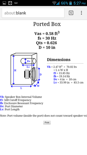

Hi guys i wanted to build a good box that can play really low bass that you can Feel and not hear. the kind that makes your heart cramp lol.
Anyways i have this box in the pic, could you guys tell me what frequency is this build? and whats the volume? im getting 2.092 cu ft and about 36ish as the hertz???
NB: the port length is from extension to port opening added.
i want to build something a little more deeper like maybe 30htz? or your opinion idk.
And this is how i wanna build it:\
Image not the measurements of course. lol but smaller :D

Its everest seaker .
But hey guys I don't know what measurements to use? If I'm using ported I want the wood to be close the back end of the magnet but not too close. So it wouldn't flopp
Abraham2nd
Posts: 474
Joined: September 16th, 2011, 7:37 pm
Location: Earth! :D
Re: Help with subwoofer box? Thx
Postby Abraham2nd » June 8th, 2016, 7:15 pm
This is what I got in some online thing when I'm plugging my speaker info but It ent give me h w and depth lol

Abraham2nd wrote:This is what I got in some online thing when I'm plugging my speaker info but It ent give me h w and depth lol
A 4" port sounds a bit too small for 2.5ft3
You will need two of those if anything.

Can anyone calculate the box for me? Just to double check my calculations? Its in my first post. And secondly can you guys tell me how to get the height width and depth from JUST the volume of the subwoofer specs I posted in the last pic?

Yeah I checked it out but one page not opening and I don't really understand it too much. I already calculated my current box BUT I wanted someone to double check it for me just in case I'm wrong . and there's another question I need answer on is how can I get a width height and depth from just the volume???

your box program calculated a volume of about 2.5cu. ft. you can play with the overall dimensions to get the desired shape/footprint you want as long as its close to 2.5cu. ft. internal volume, you must subtract the volume of the port also
A 4" round port would be fine anything bigger would need a longer port thus increasing the overall size of the box.
Ported is better for you since you want to go low and maintain some efficiency since you only using one driver, I wouldn't bother tuning below 30hz for music in a car, you should also consider cabin gain, IMO
You estimate the dimensions of the enclosure, choose a L, H, D most suitable to your trunk space, then work out the volume. If too small or too large, adjust one dimension accordingly and recalculate.
A box tuning program will give you volume and port size. Work out the volume of the port itself and make sure you minus that to the net box volume you obtain. Keep playing with the dimensions until you get it right.
T/S specs does not always give a very realistic idea on how a subwoofer will perform. Don't get carried away too much with them. Sometimes experimentation will yield better results. Use PVC for your ports, so that way you can easily adjust them (length wise) if you are not satisfied.
