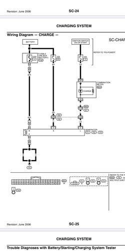

I am switching the alternator (qg) which is 2 pin labelled l and s to a tiida alternator which is labelled l,s and c.
Do I leave the c pin disconnected and connect the l and s?

I need help with this currently. Do you leave out the c? Also, my l and s on the y11 is colour coded black and cream and a yellow and red..which is l and which is s

Re: help with tiida alternator wiring
Postby goviboo » October 26th, 2020, 6:24 pm
I had to go through my notes, please note this was well over 8/9 years ago, it may or may not have changed sinceImage, I believe this should help you and the others out....
See attached.....

On the drawing, u have 1 which represents c on the plug in for the tidda. Correct me if am wrong, the 1 goes to a ground? I did this install yesterday, connected the l and s same as your diagram and I left out the c, I got a check engine light though. My y11 just has l and s on the harness. Is c going on one of those wires on the l and s y11 harneas or should I make a designated ground for the c on the tidda?
goviboo wrote:I had to go through my notes, please note this was well over 8/9 years ago, it may or may not have changed sinceImage, I believe this should help you and the others out....
See attached.....
Postby goviboo » October 27th, 2020, 8:51 pm
I don’t think the ‘c’ pin was connected. I had it on a GA15.
The service manual doesn’t even make mention of it either.

Someone told me hook the c wire to a ground. I was getting 14.2 and after putting the c to a ground it raised to 14.4..not sure if to leave it or
goviboo

Postby goviboo » October 28th, 2020, 9:01 pm
I can’t remember if I tried messing with the ‘c’ pin, but 14v and above should be good. Try looking at the impact it has on your load (current) when grounding or not.

Postby Jeremy09 » October 28th, 2020, 9:08 pm
Well yesterday I had it with the c disconnected. It started with 14.2 and when warmed up it went to 13.7. When I connected the c wire to the ground, it started 14.5 and warmed up to 13.9. The music in my car isn't heavy at all, so I bearly even get voltage drop before, but I just did the tidda alt as a precaution
goviboo wrote:I can’t remember if I tried messing with the ‘c’ pin, but 14v and above should be good. Try looking at the impact it has on your load (current) when grounding or not.

Y12 alternator only has two wires but jack has room for three
