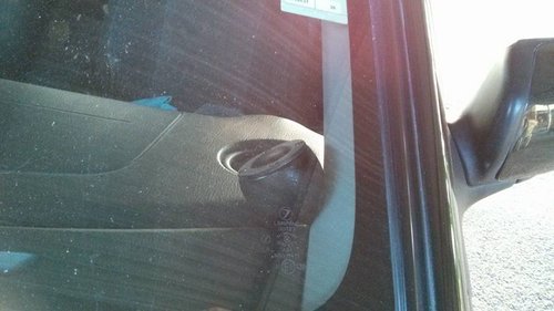

Postby Firewall » November 17th, 2015, 1:47 pm
Considered doing this but thought it would be too visible from outside the car........
Anybody have pics to show from the outside just how obvious it is?

Firewall wrote:Considered doing this but thought it would be too visible from outside the car........
Yes it is pretty visible

roger, I wanted to countersink them like in the sample pic but it would look too much like a ball cut in half if I open the sphere anymore. Couldn't get a bigger ball.
They will stand out on the passenger side I suppose firewall but on the driver side it should be easily mistaken for a gauge pod.

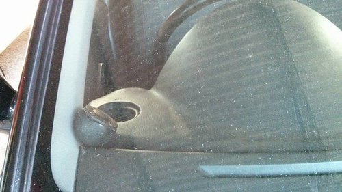

Re: Tweeter spheres, minor build mod.

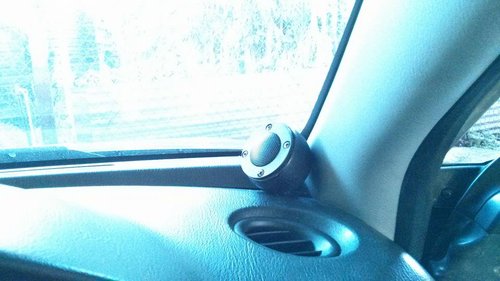

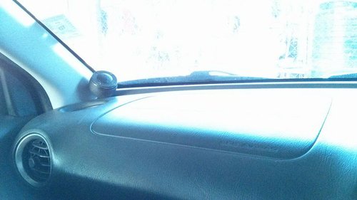

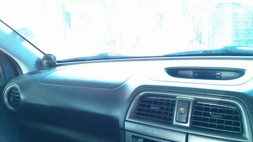

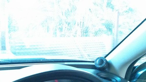

Postby nervewrecker » November 21st, 2015, 7:29 pm
Put them in today and went for a test run.
Car dirty in the pics, was clean two days ago :fadein:
Postby chosen1 » November 22nd, 2015, 2:02 pm
Looks good... Well done guy.
Not as big as I initially thought. I like it
Postby nervewrecker » November 23rd, 2015, 10:20 am
Truth be told this is a recent build. The OEM placement is on the doors but because of the space available these tweeters couldn't fit hence the need to mount them elsewhere. Didn't want to cut the A-pillars and for some reason they didn't sound all that great angled that way.
Originally some instamorph plastic I have was used to build some domes and they sounded pretty alright angled upwards. They worked great till one day the car was left outside in the carpark at work and they melted. :/
Since that I been looking for an alternative and said, hey, never tried tweeter spheres. They dont really affect the sound so to say because they are more for aesthetics but the left tweeter could use a little angling.
They might be mounted higher (maybe) as I have to find space for some gauges in the near future.
