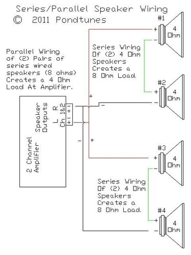

Hey i will be starting an small install similar to yours soon(first timer) and in prep i did alot of reading. i wanted to connect 4 pioneer 6.5 door speakers @4ohms each to two bridged channels and the remaining two channels to a 10 inch sub. However i realised that i needed to match the ohms of the speakers to the ohms of the amp. This helped alot...good luck with your install

TiidaBanton wrote:Hey i will be starting an small install similar to yours soon(first timer) and in prep i did alot of reading. i wanted to connect 4 pioneer 6.5 door speakers @4ohms each to two bridged channels and the remaining two channels to a 10 inch sub. However i realised that i needed to match the ohms of the speakers to the ohms of the amp. This helped alot...good luck with your install
Note this layout gives a mono output and does not keep the stereo effect.. Would recommend paralleling the two left side speakers (4 / 4 = 2ohms) and running that to one channel. Do the same for the two right side speakers and run those to a 2nd channel. That way you match the ohms correctly AND keep the stereo (left to right) alive..
the 3rd and 4th channels could now be bridged and used to power your single sub.

My amp is a Soundstream Technologies Lil Wonder 4 Channel Amplifier 620Wrms (LW4.620)
Power Rating: 80Wrms X 4 @ 4 ohms Stereo
Power Rating: 155Wrms X 4 @ 2 ohms Stereo
Power Rating: 310Wrms X 2 @ 4 ohms Bridged
door speakers are 4-Pioneer TS-G1644RPower Handling:
Peak: 500 watts per pair / 250 watts each
RMS: 80 watts per pair / 40 watts each
Subwoofer-SVC Digital Designs 510 @4 ohms 200w-400w RMS, 1200w Peak
Wiring advice?
3stagevtec
Posts: 9622
Re: Got this AMP, need help now...
Postby 3stagevtec » June 24th, 2014, 7:44 pm
TiidaBanton wrote:My amp is a Soundstream Technologies Lil Wonder 4 Channel Amplifier 620Wrms (LW4.620)
Wiring advice?
Same advice i gave before..
According to the specs, you will have 155W to the two left side pioneers and 155W to the two right side pioneers. Sub will get 310W. The speakers and sub will match that amp impedance wise.
If you need further clarification on wiring or need a wiring diagram, let me know.

run the sub on channels 1 and 2 of the amp in bridged configuration. set the crossover setting for channels 1&2 to LPF and turn the freq adjuster all the way down to 50 hz.
parallel wire the two left side speakers and run it to channel 3
parallel wire the two right side speakers and run it to channel 4
set the crossover setting for ch 3&4 to HPF and turn the adjuster somewhere close to the 500hz mark.
adjust the gains to suit.
