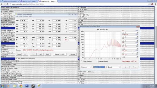

meccalli
Posts: 4595
Location: Valsayn
Re: Want to buy speakers
Postby meccalli » May 31st, 2014, 1:56 pm
Straight loading with a choked mouth to eek out as much LF response as i can.

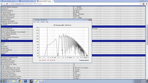

meccalli
Posts: 4595
Location: Valsayn
Postby meccalli » June 1st, 2014, 2:39 pm
Dunno when i'll actually build it, i'm a horrible carpenter lol. But if anyone wants to give it a go, here's the sim in hornresp. The first is the combined response corner loaded @ half space, excursion rockets under 38hz. The second is just the line's output. The line is 50cm^2 throughout including the mouth, length seems good anywhere from 160-200 cm, you can build shorter and damp accordingly with some loss in efficiency. Both 4fe35 and 32 sim pretty close.
southside connections
Posts: 2892
Joined: November 17th, 2006, 3:18 am
Postby southside connections » June 2nd, 2014, 10:13 am
well i'm happy to see you're proficient with horn-resp, looks good, and get over it, when u gotta build, you gotta build man!!
