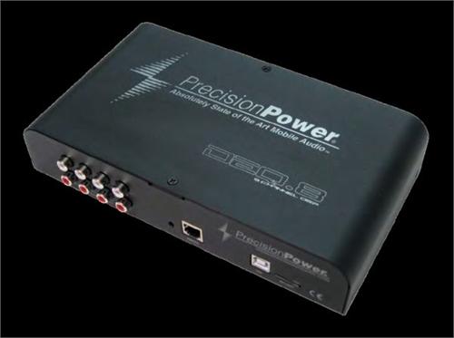

Postby SQ Audio » January 22nd, 2013, 11:16 pm
6 Channels balanced RCA inputs
accepts from .5 Volt to 26 Volts
2 Channels RCA Auxiliary Input
Toslink SPDIF Optical Digital Auxiliary Input
Cirrus Logic CS4271 DAC
ST Micro STA308A Audio Optimized DSP
8 Channels output at 6 Volts RMS
-Speaker level inputs up to 26 Volts RMS
-Channel Summing to combine active signal ranges to a single full range signal
-Voltage Sensitive EQ band/Ch to correct factory active Equalization
-Adjustment by channel or by channel pair
-10 bands parametric equalization for each Channel
-Choose a frequency or type in your own
-Adjustable Q 0.5 to 10 - ± 15dB adjustment each band
-Digital Electronic Crossover for each output channel
-HP/LP/BP/Full Range selectable
-6dB to 36dB/Octave slopes
-Butterworth or Linkwitz / Riley design
-Time Delay for each output channel to .01mm or =3mm
-Voltage sensitive EQ band lets you compensate for OEM equalized systems
-Phase control in steps at 0°, 45°, 90°, and 180°
-Muting by Channel or channel pair
-isolate the channel you are working with and turn the rest off.
-Dimensions in Inches 8.6(L) x 7.9(W) x 2.3(H)
Available Soon.

Postby SQ Audio » January 23rd, 2013, 10:00 pm
These would be here by middle of Feb or before...hold some strain.

Re: SIMILAR PROCESSOR TO DQXS
Postby nervewrecker » February 2nd, 2013, 8:46 pm
a clone of the soundstream?
