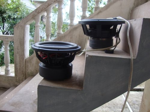

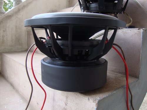

ok i hear people talking bout audio que,so i guess i can giv a little input on dis cause i have,HDC3 copper coil,
dis sub is underated first off,with the correct box dis sub can take 2000 rms daily,sub is 44 puonds,magnet is bigger dan the DDs 3500 but smaller than the 9500,the bl factor is higher on the DDs,the sub came very stiff,it was more stiff than a jugg,there is no terminals on the sub,just like a DDs wires come straight from the leads,i did alot of research on dis sub,the soft parts are not like DDs,the DDs are higher grade compared 2 these,compared to the 3500 the HDC3 are louder,the HDC3 will be louder dan the 9500 under 2000rms,but over that the 9500 will be louder,thses sub loves big ports,so dont go putting dem lil ports,on sound qulity,the sub did not sound as clean as other subs,on a tunning of 40,it hit all the lows,had no problem,i had dis playing on a soundstream 2000 picaso the sub was jus warm after hours of playing,the subs hits the higher tone alot better than oder subs,downfall is as i said before is sound quality,if u not into to much sound qulity and looking for dutty bass,audio que HDC3 will do d job

Could you provide some pics, dimensions of the magnet etc.. and what type / size / tuning box did you use for the review. It will help with the review..

im trying to upload d pics,buy pics 2 big,so ill decrease d size and see if i can get dem up

have used both the 10" and 15" model in these subs and sound quality and bass reproduction is not bad at all.I will play very smoothly in the right box so i guess your box wasnt best suited if you found it played rough..
The only problem i have with them is that the coil can not handle too much stress it overheats and burns once its being overpowered.If you remain within rec power handling its well worth the money.The soft parts are preety good for the price of the sub i love the suspension and cone.
im realy guna disagree on dat!the sub is rated at 1000rms,the sub will handle 2000 daily in a correct box,thses subs likes port area,so if u guna put it in a tiny box with a tiny port,well,?

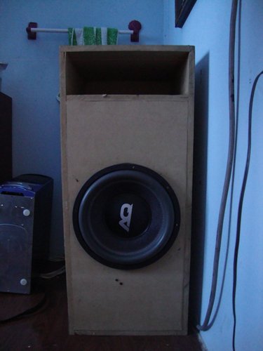

ok pallie, first off these 'lows' that you speak off are non existent with that 35hz hpf.
secondly a port area of approx 14 square inches is usually recommended for each cubic foot. 72 square inches seems a bit too much for that 3.6 cubic foot enclosure.
have you had that picasso clamped to see what its power output really is?
No amp will put out full power with music as its output will be constantly fluctuating. Even if it was 1800watts it will only be putting out a fraction of that power so that sub was not even seeing anything close to that 1000 watt rating.

ok y wud a mono have a high pass?and if u read good u will see i said dat i cut port dat y d subsonic is on 35,the box i had b4 subsonic was on 25,even if u research it online u will see the sun will do 2000 daily,the power acustic db an picaso carry the same bored,and yes,sum1 did do a bench test and came out with close to 1700rms,u d first who said dat u cant over power the sub?if dats d case it should be classes with the dds 1500,in terms of loudess and power handling its class above the 3500 and below the 9500,u tink 72 inches is 2 much for dat sub??u must be joking,

smaharaj wrote:ok y wud a mono have a high pass? its called a sub sonic filter and if u read good u will see i said dat i cut port dat y d subsonic is on 35,the box i had b4 subsonic was on 25,even if u research it online u will see the sun will do 2000 daily I thought this is your review? ,the power acustic db an picaso carry the same bored that dont say squat, a lot of amps have the same board but the components are different making the amps different,and yes,sum1 did do a bench test and came out with close to 1700rms with music or a test tone?,u d first who said dat u cant over power the sub? I never said that if dats d case it should be classes with the dds 1500,in terms of loudess and power handling its class above the 3500 and below the 9500,u tink 72 inches is 2 much for dat sub??u must be joking, I said for the enclosure it is. tell me, whats the length like?
give me the dimensions of the enclosure (external & internal) & thickness of mdf leme see if I can model your enclosure & plot the response curve.

You can experiment with port area it doesn't have to follow 12-16Square inches per cubic foot.

its in d car,i jus took d pic in d room,

give me the dimensions of the enclosure (external & internal) & thickness of mdf leme see if I can model your enclosure & plot the response curve.[/quote]
amm,even if u do model d curve,its in a car,so its guna sound different,ill message u d specs i used
