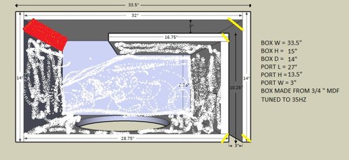

the first box is what my subs are currently in it plays a nice mixture between low and loud but does go as low as i wud like it....
this second box is a box i wud like to build and test to see if it meets my requirements a lil better than the first box
wat do you guys think any feedback wud be great in terms of size and tuning, subs are 2 kicker l7 8"

click to zoom in, the triangle thingy just makes sure that when the air meets it is directed out of the port instead of battling in the 13.25" chamber, the orange-ish parts are what I think it should look like ( slight flare[cud correct meh on dis])
and 45 the corner b4 the port, [the north east and north west corners]
Add damping material like in the 2nd pic if ya want, was too lazy to do it in paint
Again, 45 the corner b4 the port, [idk it seemed like a good place to put it]
definitely want to 45 the corners inside the port, better air flow,
damping optional (the fuzzy white stuff)

Postby spam » June 1st, 2011, 7:26 am
ruffneck_12 wrote:click to zoom in, the triangle thingy just makes sure that when the air meets it is directed out of the port instead of battling in the 13.25" chamber, the orange-ish parts are what I think it should look like ( slight flare[cud correct meh on dis])
if the corners are not 45 as u suggested would it make a big difference ? i mean a difference you can actually hear ?
viking1705
Posts: 705
Joined: December 1st, 2008, 3:12 pm
Re: boxes for my subs
Postby viking1705 » June 1st, 2011, 10:12 am
yes it can.The 45 degree corners improve air flow and reduces turbulence in the box.

ruffneck_12 wrote:
Spectro Vibez wrote:One like this...........was one of my previous project
yes Yes YES!!!!!!!!! :yankit:
Honestly, while they look good, I'm not sure if those modifications within the vent make much difference.
I suspect that chamfering makes the most difference when done at each end of the vent (i.e. inside and where it exits the box).
Also, chamfering only one end of the vent (typically where it exits the box) is a common error that should be avoided wherever possible.
