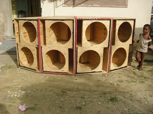

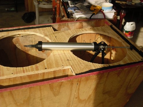

i decided to build my own sub box aw sb850z sub box some of the material i got for my work and i brought the rest. here is my list
10 sheet 3/4" construction ply [ not the best choice but don`t argue when you get six sheets free]
600 2" gypsum screws
1lt wood glue
6 cartridge black roof sealant silicon
will add more later

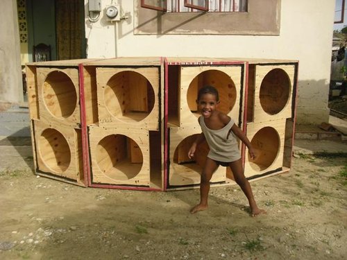

this is the end product and the small-man well he just like to help he is the PROJECT MANAGER

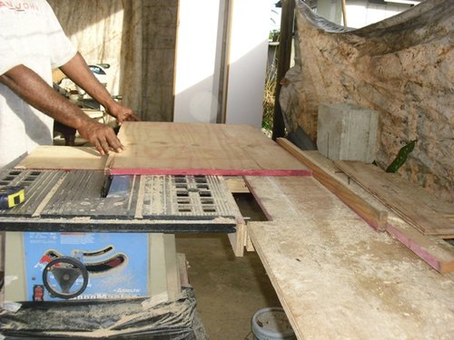

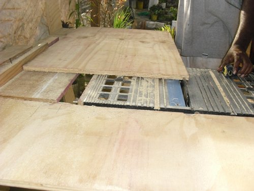

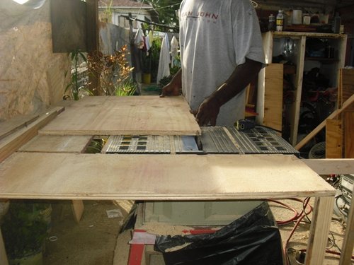

this was done on a a table top rip saw

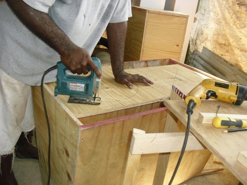

SOME OF THE TOOL ARE JUST YOUR EVERYDAY TOOLS
SOMETIME I ASK MYSELF WHY CONSTRUCTION PLY

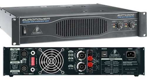

i am using the zebra power woofer loud speaker system, double layer magnet
eight to be exact
2-europower EP4000 base line
2-europower EP2000 tops
as soon as the money comes in i will buy the top for the bass line but right now i am using two Gemini GT3002 Dual 15" 2 Way Passive PA Cabinet [old school model]
There’s plenty of awesome features on the outside of the EP4000, but there’s also a team of cool components on the inside helping it work its magic. it come loaded with famously reliable Toshiba/Fairchild power transistors as well as a high-current toroidal transformer for ultra-high transient response and further reliability. Independent DC and thermal overload protection on each channel automatically protects the amplifier and speakers from any show-stopping meltdowns. There’s no need for fuses, giving you one fewer potential mid-gig headache.
