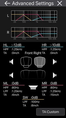

Just a question, I have tweeters on my dash.What frequency should I highpass at.I currently have them at 2k Hz
At the moment, there's two filter settings on both the subwoofer and the front speakers.
Subwoofer
Amplifier: 120 Hz 24dB/oct low pass
Head Unit: 160 Hz 12dB/oct low pass
Front Speakers
Amplifier: 70 Hz 12dB/oct high pass
Head Unit: 100 Hz 12dB/oct high pass

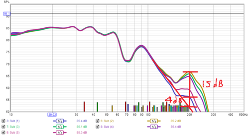

The filter points were chosen based on:
1. The raw measured response of the subwoofer and front speakers measured in-car
2. To limit power to the front speakers while still getting decent mid-bass up front.
3. To get as good phase tracking as possible between the sub the front speakers.
Note that electrically, none of them "match".
I still have a bit of work to do on the phase tracking as I'm getting some cancellation at 200 Hz, but I suspect that's due to the "bump" that shows up in the subwoofer's response in-car around that frequency. I really need to invest in a good DSP, LOL.
Too answer your question about the tweeters, basically the same (or similar) guidelines apply, i.e. filter frequency and slope should be chosen based on:
1. The tweeter's in-car response curve (and what you're trying to achieve)
2. To limit power at lower frequencies (don't want to blow the tweeter)
3. To get good phase tracking between the tweeter and the rest of your system.
That said, 2kHz sounds kind of low for a dash tweeter.

The 2 k is the highest setting on the head unit.Some time this week , I will set crossovers properly on the amp using a voltmeter, thinking around 4.5- 5 k because that's where my mids drop off.

Steele, what rta curve do you aim for? I accustomed to the Harman curve sound so I tune for that
Brian Steele
Posts: 877
Joined: December 3rd, 2009, 5:37 pm
Re: Budget 6.5
Postby Brian Steele » October 27th, 2021, 9:18 pm
timelapse wrote:Steele, what rta curve do you aim for? I accustomed to the Harman curve sound so I tune for that
I aim for something similar, with a couple dB more bass below 80 Hz. My car-audio system can sound good, but I won't really classify it as an "SQ" system. It's a smooth-sounding system which allows me to crank the bass on the days that I want to :-). It's probably because I don't consider it as a "real" SQ system that I haven't gone the full DSP route. I'm just using my 80PRS for tuning, and that's a bit like trying to shave with a carving knife....

but u eh say if EQing solved ur issues
why cut so high at 160hz - mamoo eh like midbass in his music ? , if ur sub is playing from 80h down or even 100 thats a fair chunk of frequencies missing there
look at d response graph for each speaker then still ask for a demo from wherever u buying it from ...

How come you didn't time align your tweeters there Ted?
kavaninho
Posts: 847
Location: Gasparillo
Re: Budget 6.5
Postby kavaninho » November 5th, 2021, 12:40 pm
Ted_v2 wrote:
rollingstock wrote:You shopping in the wrong place in south then.
The number for the TA used here is the difference from the furthest away driver? How you arrived at those figures?
Posts: 8838
Re: Budget 6.5"
Postby timelapse » November 5th, 2021, 2:28 pm
That's how the pioneer app works Kavaninho.
You have to input the physical distance of all the speakers from the listening position.Deck does the calculation
