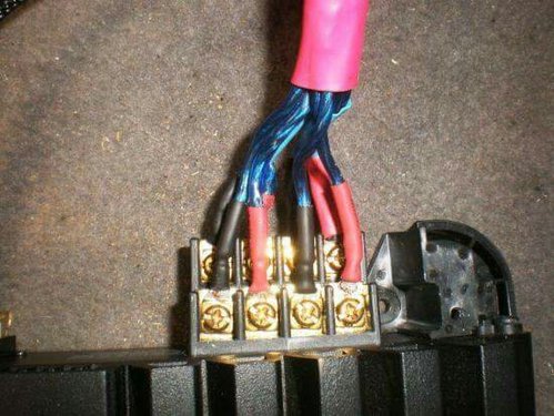

nervewrecker wrote:Heat shrink kit purchased from allied industrial, my next home
I put a little silicone on it prior to heat shrinking it. Helps with an air tight seal
Silicone is salt based and area will end up rusting due to moisture build up! You should have used white lithium grease
Thanks, will do them over.

Postby adnj » September 10th, 2018, 9:40 am
adopson wrote:
Some silcone sealants are acidic and can cause mild corrosion during curing but I don't believe that salt has anything to do with it.
If you are trying to prevent terminal junction corrosion, you need what is called a gastight seal:
- Use a bare terminal only.
- Solder or crimp-and-solder terminations using rosin-core solder only.
- Cover the wire and terminal base using dual-wall heat shrink only.
Moisture trapped under the terminal cover and wicking can cause corrosion. Using acid-core solder will cause corrosion. Use a spray-on silicone lubricant (or lithium if you can stand the mess) to act as a sealant AFTER you have made your final connection.
Use the spray lubricant irrespective of how you terminate. The lubricant makes the junction hydrophobic and less likely to corrode. Depending on the location, materials, and the electrical system in question, Vasoline, dielectric grease and WD40 work very well, too.

There's a heat shrink tubing that we use with glue on the inside which melts and oozes out when the heat is applied. Have to order online though, kinda pricey.
Re: Mazda BT-50 build. JBL, Hybrid audio, Image dynamics, Powerbass, XS power, Digital Designs
Postby adnj » September 10th, 2018, 2:07 pm
kavaninho wrote:There's a heat shrink tubing that we use with glue on the inside which melts and oozes out when the heat is applied. Have to order online though, kinda pricey.
You might find it an electrical supply store.
Anands, Modern, Mepco, etc., all sell heatshrink by the foot.
Postby X_Factor » September 10th, 2018, 4:17 pm
I know self adhesive heat shrink is used mainly for marine applications where they have to deal with moisture and salt
isnt it a bit overkill for basic speaker termination?
once a decent quality wire was used and crimp/ solder done well the regular heat shrink wont work?

Postby nervewrecker » September 10th, 2018, 6:04 pm
The silicone was really to keep moisture from getting in and corroding the wire inside the insulation. I the pastI have used heat shrink and found like it gets loose over time. Not sure how or why but first time I am using this set so not taking chances as this going to be all over and in any terrain..

Postby adnj » September 10th, 2018, 6:24 pm
X_Factor wrote:I know self adhesive heat shrink is used mainly for marine applications where they have to deal with moisture and salt
Dual-wall is used in any application where you want to slow fluid ingress or have a thicker wall for protection like on a sonically spliced cable. It is also required by code when splicing direct-bury electrical cable.
In my experience, a well done crimp (with the proper automotive terminal) or soldered connection is more than enough for almost any vehicle connection that is inside of the cabin.
If those speaker terminals are going outside the vehicle, a pigtail wire should be soldered to the speaker and the connection made with a submergible (not a typo) connector.
That said, build it how you like so long as it works properly. Or just build it again.
Most of the terminations that I am seeing are standard electrical panel terminals and not automotive terminals.
Automotive terminals crimp the wire and insulation separately and require a different crimping tool.ImageImageImageImage

Postby X_Factor » September 10th, 2018, 7:01 pm
those were used in this install a few years ago
but even if I get those with the insulation attached I take them off and solder with heat shrink
Postby nervewrecker » September 10th, 2018, 7:48 pm
You are right adnj, those are terminals I use to do work in the field with. Wasnt aware there are different ones.
Will look into it or go the way x_factor did..
I prefer to build it proper the first time around and have no issues so the feedback and advice is very welcome by me and im sure anyone reading all this will appreciate it as well.

Picked back up my amp this evening. So weekend something will happen if I gave time.
