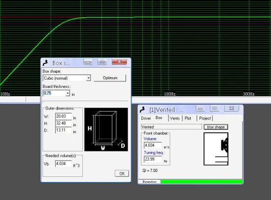

so i just ploted out the TXXAP15 in WinISD an it has a VERY nice freq response!
by the way what is the BL and Sd of a sub? i left those fields blank...
but the box has to be 4 frickin cft... tuned to 24 Hz (Optimum)

bl is supposed to be something with the voice coil conductor length ( gap's flux density related) IMO...i eh fully kno..
lemme google that
Sd is simply something like the "effective" surface area of the sub...which is basically the area of the subs cone and a small portion of the suspension..( someone correct me if i`m wrong)

BL
(measured in Tesla meters) The product of a speaker driver’s gap flux density and the length of the voice coil conductor in the gap.

yuh kno i google it an eh get nutn..
but watch how it respondin at a flat 0db all d way down to 30hz!!!!
