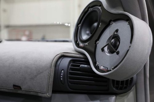

My raj build done. "takes licks all how"
it consist of a pair of faital pro 6fe300 and a pair of skyhigh car audio titanium dome tweets. I added the head rest box's specs to winisd and got a tuning of 200hz (trini customs told me 150hz) anyway, the faital playing 200hz to 4khz and tweets 4khz-20khz.
1. I have to set the gains for the tweeters, i know some recommend using music an setting by ear. what are some good songs to test/set tweets?
2. this for a loud daily and not sq, i have one of those free apps for an RTA, what type of graph to aim for when tuning?
Thanks fellas, "takes more licks in advance"
Problem with loud,is where are going to rta from?Driver seat ,in the car,out of the car,how far from the car? Questions a raj should ask himself.Why RTA at all?
Now if you can find a singular listening point young Raj, because you will not get the same RTA from different listening positions.RTA curves may change at different volume levels also.Choose wisely.
When you figure all this out over a bowl of dhal and a nip of puncheon with medium pepper, try this curve with white noise at -3 db(you can find this online).This is for your entire system, not just the tweeters.
Tweak from there using Jab Kisiki by Kumar Sanu or Musafir by whoever covered it last.
Extra tweaking can be done using Lalana Khoosie by Sam Boodram.
Happy Rajing
Hahaha was thinking to place my phone in between the driver an passenger seat? As fas as outside, its just 2 6". Not sure if my phone will read to well..
wait, you serious about them 2 song to set the gain for the tweeters? And as far as volume to rta, your right, i saw the curve changing as i raised the volume, thinking to work with about 3/4 vol.

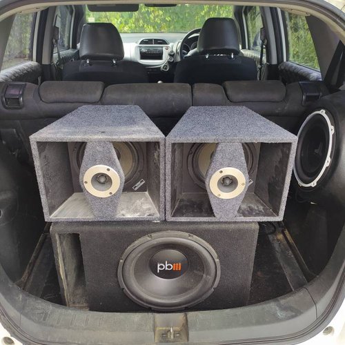

Welcome to Rajistan

I have 2 flare box I feeling to throw in for the parang season for real inno

Lawd! Postman flare box and thing. We'll pretend the JL not there lol.

JL is safely disconnected.

Never understood the flare box thing. Short parabolic expansion for midrange duty? Can't imagine that sounding anything else but awful...

It is awful.Loud and awful

Brian Steele wrote:Never understood the flare box thing. Short parabolic expansion for midrange duty? Can't imagine that sounding anything else but awful...
It does make d mids clap and sound better from far bai!!! Yuh wa Tess the mids box? Grand bazaar meet up!!

Postby timelapse » October 16th, 2022, 5:49 pm
Not keeping indefinitely.I just need to be slightly louder than the Jamaican over the road that feels the need to preach for Diwali and Eid.

Lemme add to the discussion

Postby Rovin » October 16th, 2022, 10:55 pm
^^^ i would like to see d other side too ... :|

Postby Dave » October 16th, 2022, 11:00 pm
Dash mat is a foreign thing. Lhd business.

Postby timelapse » October 17th, 2022, 3:45 pm
Dyn Audio is the bomb.
Not for Raj setups
