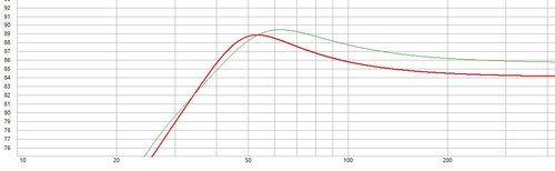

This is a request for clarification from those of you who understand these things more than i do.
I have modeled 2 subs in WinISD in a 1cuft ported box for 36Hz
JL 12TW3-D4 and Pioneer TS-SW3002S4
The SPL curves are as follows, JL red and Pioneer green with a less than 1dB difference at 40Hz.
To my eyes, they seem very similar and not what i expected based on price and brands. Are there other curves i should be looking at (although all seem similarly close) or other parameters i should be varying? Or is it that these two are so similar?

^I'm not sure if you inputted the TS correct there. I had the 12TW3 in my WinISD database and the plot is no where as misaligned in your screen shot. Verify the TS against the manual.
Sure there are other plots to looks at, however, try to flatten those responses first.

1. Efficiency at low frequencies is largely a function of box size and tuning
2. WinISD is an inaccurate modeler for car audio designs. It does not take "cabin gain" into effect. Nor does it accurately model the effect of Le, or the effect of "semi-inductance".
3. The mantra for car audio subwoofer design is - design for power-handling, fix FR with EQ.
4. To design for power handling, make sure that driver does not exceed Xmax in the passband (that region above Fb, the resonance frequency) for up to at least 1/2 of its rated power. In other words, if given a driver with 200W power handling and 12mm Xmax, when trying to come up with a good box design for it, make sure that box design does not have it exceeding 12mm Xmax when fed with 100W. If you're planning to feed the driver with more than its rated power handling, use that input power instead (e.g. planning to use a 500W amp, make sure Xmax is not exceeded @250W).
5. A 36 Hz Fb is a bit high for a 12" subwoofer design for car audio use, unless you're designing for SPL. Try 30~32 Hz, or even sealed (but see note #4 above).
6. Make sure that you have good EQ :) (see point 3).

kavaninho wrote:^I'm not sure if you inputted the TS correct there. I had the 12TW3 in my WinISD database and the plot is no where as misaligned in your screen shot. Verify the TS against the manual.
All parameters are verified from the manuals for both.
I'm not concerned with anything except the similarity between the two as my brain says they shouldn't be so close.

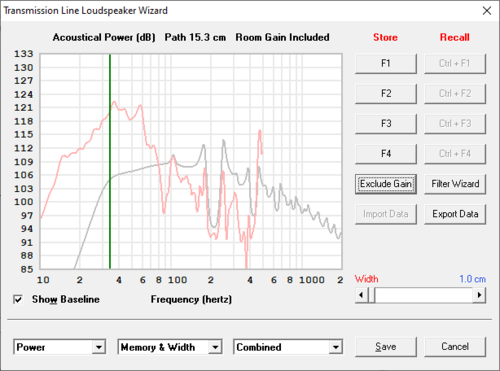

kavaninho wrote:I did not even know people use point 3 above as an approach. I guess if you have capable DSP you can. IMO usually the more EQ and "DSP capability" you require after your system was built indicates poor decisions in the earlier stages whether it be driver selection or system design.
That advice was shared with me years ago by someone who used to work for Infinity audio, and what he said makes sense. Even now, most people use box design programs that don't take all the necessary details into consideration (one of the biggest being the transfer function of the car's cabin), so it's best just to design for power handling and fix the response with EQ.
This is a worked example - this is a dual-driver offset transmission line design using 6.5" drivers that was considering for my daughter's car. The grey line is the 2PI predicted response of the build. The red line is the predicted response at the driver's position when the car's transfer function is taken into consideration. Not the flattest, is it? I might build that and fix the response with EQ - or just go for a sealed 10" design instead.
