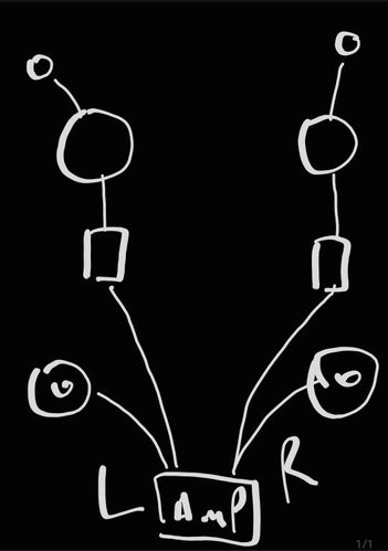

Doing some for a friend here. She has a 2 channel amp rated 75rms @4ohm x 2 and 125rms @2ohm x 2. She ordered on amazon a random set of cheep speakers for her doors. Componets (6.5", silk dome, crossover) 4ohm and a matching pair of 6.5" coaxial speakers for the rear,4ohm. Can i join them and wire them stereo @ 2ohm?
In terms of SQ, is just an upgrade, she doesnt need proper imagining ect. I might eq a bit off the deck. Thanks

imo 4 speakers both front & rear playing off same power usually messes with midbass response but yes it will work like how u want to wire it ...

Rovin wrote:imo 4 speakers both front & rear playing off same power usually messes with midbass response but yes it will work like how u want to wire it ...
I'm not sure how it affects midbass.... any insight?
Re: Car audio advice thread
Postby Rovin » June 6th, 2022, 6:21 pm
if both front or rear is on equal volume i find u get some midbass cancellation issues, as though either d set in rear affecting set in front or vice versa & yes all speakers are in correct polarity & set correctly to either left or right as indicated by each channel
try either fading front or rear u will hear a nicer midbass from d set that has more power on it , try it & tell me if u hear differently ? , it is possible results can vary with different vehicles
personally i dont care much for rear speakers , if they are already there i will fade them down so u barely hear them just for rear-fill ...

Fire for the coax.use the comps alone and it will sound good
nick639v2
Posts: 2759
Postby nick639v2 » June 6th, 2022, 7:19 pm
Run the coax off deck power and the comps off the amp and call that a day.

Another thing. If you want to run 2 sets of components. Front and rear off that same 2 channel, so i wiring it to 2ohm instead of the 4ohm. (A pair on left, a pair on right) again not strick SQ.Mile tuning of the deck. Will it sound off and will the quality drop if using a reputable amp?

Jeremy09 wrote:Another thing. If you want to run 2 sets of components. Front and rear off that same 2 channel, so i wiring it to 2ohm instead of the 4ohm. (A pair on left, a pair on right) again not strick SQ.Mile tuning of the deck. Will it sound off and will the quality drop if using a reputable amp?
Do have independent control of each driver in the system? No! Then your Sound Quality will suffer. Coaxials are perfect for the rear fill, and I'm pretty sure easier to install.
Even if you have "kilometer" tuning on the deck you wont be able to correct the phase issues when you are limited to a 2 channel amp powering everything.
In terms of SQ, is just an upgrade, she doesnt need proper imagining ect. I might eq a bit off the deck. ThanksScreenshot_20220606-104910_Samsung%20Notes.jpg
What type of processing? If deck, model? Standard or network?
Depending on these answers running rear fill from the deck will be a no no.

but btw why does d "friend" need 2 sets of comps upfront ? , their hearing not so good orrr , 1 pair of comps properly set up will surprise u
get a good reputable 4 chan amp & do it right d 1st time ....

No no, my friend runing the comps infront and the coax in the back with the 2 channel amp. I was just inquiring what would happen if you do comps infront & comps in the back off the 2 channel, what would have happen having them at 2ohm instead of 4ohm na.
Postby Rovin » June 8th, 2022, 7:33 pm
in theory d amp will see a 2 ohm load\channel & shud be able to play them ...
It theory,that going to sound like sheit

Not necessarily but it would be dependant on the vehicle greatly. For instance the b17 Sentra rear doors are designed with a plastic 'enclosure' that plays lower than the front doors. I think by design as a type of rear 'sub'.
Without being able to eq or ta each speaker it may sound like toos
