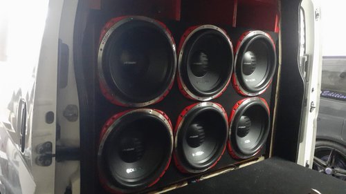

build is like 90% completed. What killing me now, is taking a chance during the SOE to go an tune.

From the Orion HCCA manual... "Please Note: Due to the extremely long excursion and high temperature possibilities of this woofer, it is recommended that when the woofer is installed it be positioned so that the cone either faces upward or downward only."
Jus sayin; :-)
Looks like that build is going to make some beastly bass....

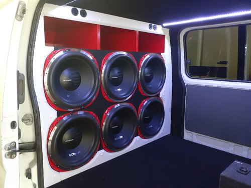

Postby shake d livin wake d dead » August 17th, 2021, 5:24 pm
It done

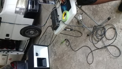

Day1: tuning....blasted rain....tuner is ah BOSS....so we still made it happen
For those interested, tuner is randy aka bassgod aka chunky...was one of Rent A Amp's main sound engineer.

just asking to know how they do tuning for these kinds of systems : run pink noise, use a rta mic\rta software then adjust crossover points, eqs, levels accordingly ? ...

Postby kavaninho » August 25th, 2021, 12:08 pm
shake d livin wake d dead wrote:Day1: tuning....blasted rain....tuner is ah BOSS....so we still made it happen
Is that the RTA mic laying on the ground taking the measurement?
Correct is right. The driverack was programmed before we went out into the open to make final adjustments. This took some time as we did not want to chance the weather. Took at least another 45 mins out in the open to get it going (pink noise, time delays etc)
Yes it is.

^ That is not ideal at all.
Re: E25: 6 15S build
Postby shake d livin wake d dead » August 25th, 2021, 4:59 pm
kavaninho wrote:^ That is not ideal at all.
Nope its not...when we went out in the open, the correct thing was done

Postby Brian Steele » August 25th, 2021, 8:56 pm
Actually, if you were doing what's called a "ground plane" measurement, it can be quite accurate.

Tbh, I didnt really ask much questions as I have a lot of faith in the tuner. Once it was pleasing to my ear in the end...it was all good!
I was made aware of the pink noise aspect, time alignment etc when we were out in the open.
