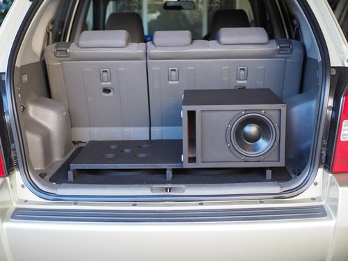

Brian Steele wrote: Doesn't take up much space and with enough power provides all the SPL that I want.
I forgot one more thing - it allows me to carry other stuff in my car's trunk :-).
The two 12s are actually mounted below all that crap in that image, in a fiberglass enclosure built into the car's spare tire well. The wooden grille above it was a temporary one that I was using until the stainless steel replacement was finished.
