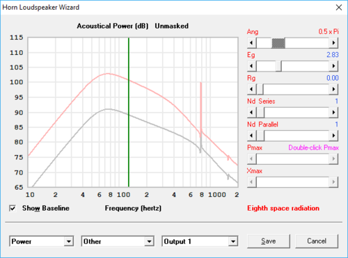

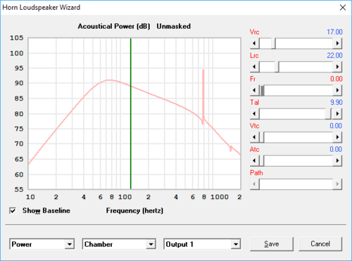

Postby Brian Steele » November 20th, 2018, 10:22 pm
kavaninho wrote:0.5xPi wouldn't be the space in this application?
Some people use 0.5PI modelling to get an idea of what the in-car SPL might be like. I prefer to stick to 2PI @ 2.83V for most of the models, for easy comparison with other modeling programs. As you can see below, switching to 0.5PI does not really emulate the 12dB/oct cabin gain at low frequencies that you'd get in many cars.
