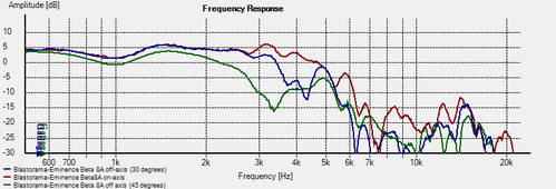

infinite_RPM wrote:The crossover points on the deck for the low pass only goes up to 250 which is a total waste since the 8s can go up to 5500hz
LOL - likely only if it was facing you directly :). An 8" driver will start "beaming" long before then. You can expect the off-axis response to start dropping a lot earlier than 5.5 kHz. For example, here's some measurements I took of the Eminence Beta 8A in my Blastorama project that show it's off-axis response. I was trying to determine the best x-over point. Around 2 kHz or below seems best, but I eventually ended up with 3kHz for a number of reasons, including I didn't want a fuckwit at the volume control blowing up my tweeters because they were crossed over too low.
infinite_RPM wrote:Or I can go two way and have a simpler setup since the tweeter can play down to 2000hz
"Can" is not the same as "should" :).

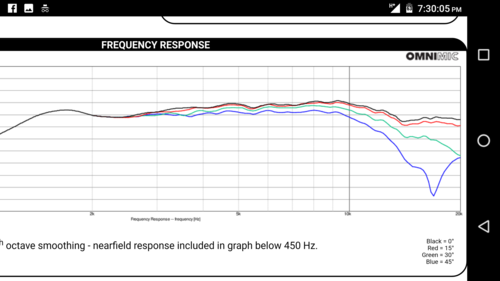

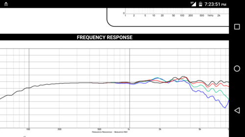

Just for fun resp graphs
This tweet is one of those planar tweets... I went a lil overboard at parts express and buy stuff
Tweet

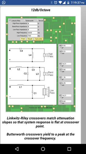

do the components affect final impedance in the crossover? Or does it operate like a normal circuit in terms of impedance calculations?

Yeah I should of been more clear that's what I wanted to know lol.. like if u have a speaker with an inductor and capacitor on it if it will affect the impedance.
Need to know to finalize crossover design so I choose a suitable amp

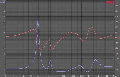

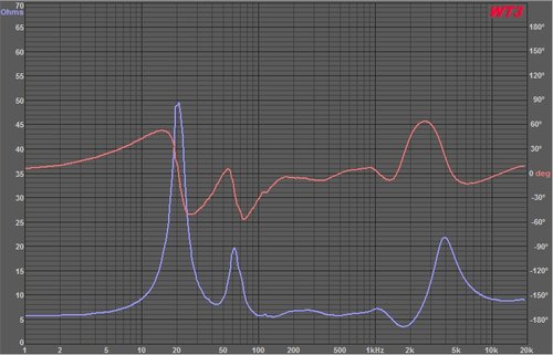

...and here's an example of a bad x-over. This was a commercial three-way pro audio system. Note the impedance drops BELOW the minimum resistance of the bass driver (around 5 ohms) between 80 Hz and 400 Hz, and again just below 2kHz. This could have been avoided with proper x-over design.

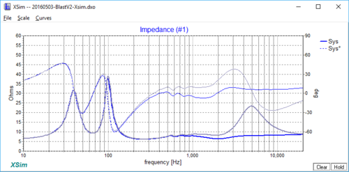

Simple - design with impedance response as well as frequency response and power-handling in mind :) . This in turn requires the use of a good x-over design tool like XSim that can easily model these things.
Here's what the impedance response of a redesigned x-over for this particular speaker looks like. There were still one or two issues with this particular speaker that needed to be addressed when I took this measurement, a few that can be quickly identified from the response curve. I decided that the dip at around 1.8 kHz was small and over a very short frequency range, so it did not warrant any work to address.
