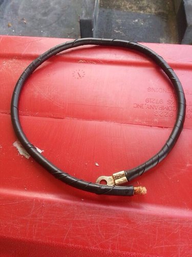

Postby Aaron 2NR » March 19th, 2014, 10:17 am

Aaron 2NR wrote:
This was done by a very popular shop in south ;)
This looking like something that Smalls Elec.....ummmm yea, would do..lol :drinking:
Lance
Posts: 2736
Location: Arima<->Leeds
Re: Have your audio professionally installed?
Postby Lance » March 19th, 2014, 10:58 am
Assuming that's a ground connection.
What's wrong with it?

Postby wickedbreed » March 19th, 2014, 11:00 am
Man talking bout how the wire wrapped in tape...I lold at the fact that the ring terminal didnt look like it was crimped nor was it soldered...

Postby Lance » March 19th, 2014, 11:04 am
It's seemed crimped well enough... Could probably use some solder though.

Postby wickedbreed » March 19th, 2014, 11:08 am
Lance wrote:It's seemed crimped well enough... Could probably use some solder though.
Look closely at end if crimped it isnt tight. Seems as 1 tough pull and it will come out... :|

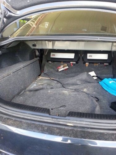

Postby Aaron 2NR » March 19th, 2014, 11:08 am
kavaninho
Posts: 847
Location: Gasparillo
Postby kavaninho » March 19th, 2014, 11:48 am
Ok first thing i see there is the distro and fuseblock. Wouldn't the wires be moving if the backrest is raised/dropped, that can definitely come loose .
!!!!! Is that box on the left his battery area? Is it sealed and vented??

Postby kavaninho » March 19th, 2014, 11:51 am
oh and those crimp terminals, once done with the right tool the right way, they is no need for solder, hence the name crimp terminals. I' ve noticed people here using solder on almost all sizes of their crimp terminals, this is not supposed to be.

Postby wickedbreed » March 19th, 2014, 12:35 pm
kavaninho wrote:oh and those crimp terminals, once done with the right tool the right way, they is no need for solder, hence the name crimp terminals. I' ve noticed people here using solder on almost all sizes of their crimp terminals, this is not supposed to be.
Look at name of ched again...but I kno most technicians put the solder as a failsafe/backup incase...

Postby kavaninho » March 19th, 2014, 12:43 pm
^^ ah glad you said that, so therefore most audio installers locally have lack of tools?
Comes back again to say a jigsaw and a screwdriver doesn't make you an installer.
