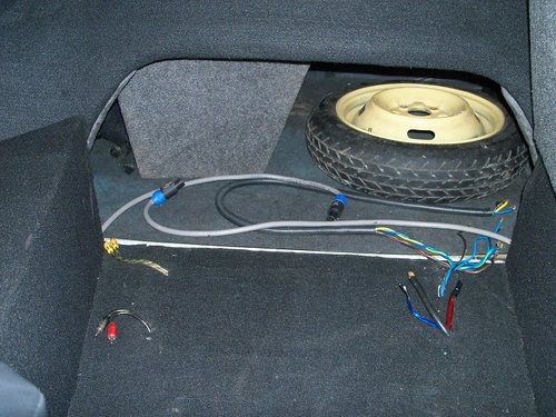

OP : u shud put up some pics of d inside of this car where d sub box going so everybody can get an idea ....

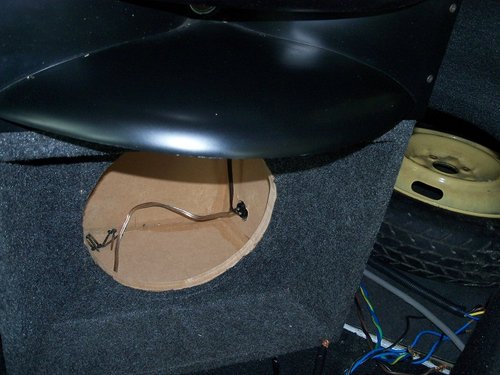

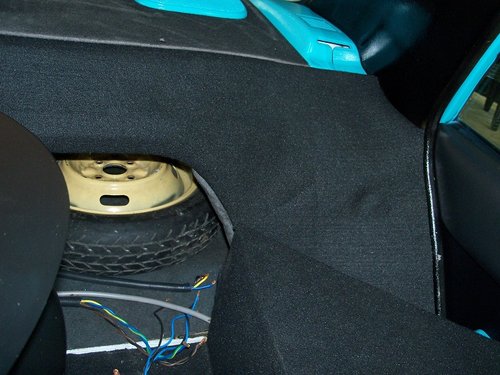

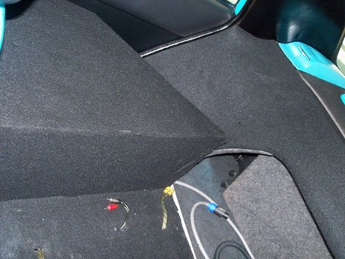

Re: W.T.K how should i do this( pics of the future project)

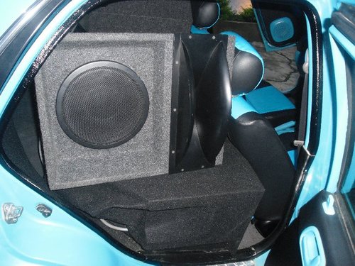

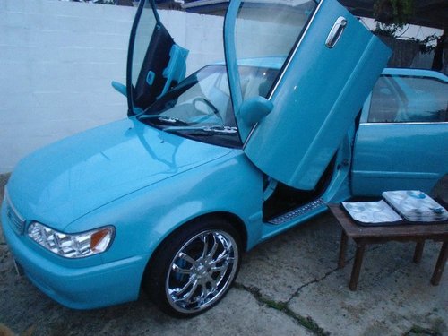

Postby shake d livin wake d dead » May 5th, 2011, 8:42 am
well im showing the vehicle and what im working,alot needs to be done still,what u seeing in the back right now is from the previous system,if u notice the stands at the ends,thats hwere i wanna fit the bigger mids box,we decided we using for 4 12's.3 across one in the middle box like a 'T',highly unlikely 6 wud fit.in the back dash is where the other mids speakers would fit and well all amps in the trunk.

^^what was the system before?
Posts: 33205
Re: W.T.K how should i do this(pics of project up)
Postby shake d livin wake d dead » May 5th, 2011, 12:36 pm

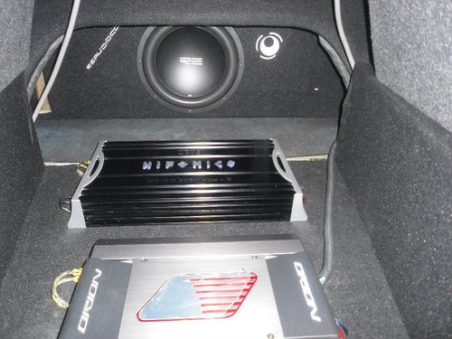

pic of the old system
Postby nervewrecker » May 5th, 2011, 12:42 pm
just take off the wings...sorry...I mean doors & get the boxes in there.

nervewrecker wrote:well since you asked nicely (although i'd think your installer will be telling you these things).
I see no room for that pre, what you gonna do with the sub out from it & you have another sub out from the kx3 already? the EQl offers far more flexibility in tuning & processing.
I'd go from front & rear out the head unit into the front & rear inputs on the eql. plug front & rear outputs from the eql into that of the kx3 to adjust your HPF's.
split the rear outputs from the kx3 into the kicker 2ch & ch 1& 2 on the 4ch. parallel th drivers & connect them to the 2 ch & on the bridged channels on the 4ch.
Activate the x20 multiplier switch on the front output & plug that into ch 3 & 4 on the 4 ch. set the amp onboard xover to fp & use the hpf filter from xover. parallel high frequency drivers & connect them to those 2 channels in bridged mode.
plug in the sub output from the xover to the stetsom input.
make sure power cables are of sufficient size to accommodate the current draw, do the big 3 upgrade, upgrade battery bank (can you specify what 2 singer batts you gonna be using) & upgrade charging system (alt).
i think he can use d pre to tune mid-bass frequency... d eql purely on the drivers ( being 1 pair input > output) it is hard to tune mid-bass n high freq with only 1 pair of outputs on a eql (if mid-bass freq leak to the driver the coil can damage easily) d bass can run direct into the cross from d deck sub out.. would have been nice to have a matrix to boost all dis processed signals after the cross... splittin the signal out of any processor is a bad idea as this breaks down the signal strength, wud hav tried that config wit d equip mentioned if was me..
jus my 2cent.. 8-)
