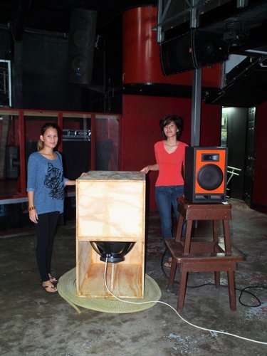

My POC4 tapped horn which uses an 18" driver. can easily reach below 40 Hz (down to 33 Hz in-room) and it's nowhere near that size. 22.5" x 40" x 32".

like your pic how does it perform in the open?

Dead flat from just below 40 Hz to just over 100 Hz, according to one quick measurement I took. Efficiency is a bit lower than bigger BLHs or FLHs though, but that's to be expected as there is usually a direct correlation between size, LF cutoff and efficiency (the "Iron Law"). Calculated efficiency is supposed to be just above 100dB/1W/1M in its passband. Fb is actually 32~33 Hz, so a little parametric EQ can extend its LF response even further.
Right now it's still a "Work In Progress". See that rope coiled up below the box? That was to stop it from moving back every time we ran Oliver Helden's "Pickachu" with its 30 Hz content (https://www.youtube.com/watch?v=YvmmIw_gnag) through it at high levels to test its peak SPL capabilities at low frequencies :-).

Brian, where are the specs for that enclosure, and what sub did you use in it? It looks similar to the Cubos I built.
Brian Steele
Posts: 877
Joined: December 3rd, 2009, 5:37 pm
Re: MY SB850Z PROJECT [aw subs]
Postby Brian Steele » August 23rd, 2015, 8:11 pm
Kasey wrote:Brian, where are the specs for that enclosure, and what sub did you use in it? It looks similar to the Cubos I built.
See here - http://www.diysubwoofers.org/projects/other/POC4/
The driver is the B&C 18TBX100-8. The TBW100 should also work, and give quite a bit more peak output.
It's still a WIP. I've recommended to the builder to add another layer of 3/4 ply to the bottom to stop the "walking" (a side-effect of cutting down on the amount of bracing that I recommended).
Funny thing is, I estimated about 5L of cone compensation would be required, and it turns out that 7.5L is a bit closer to what's needed. Makes only a minor difference around 120 Hz, so I'm not too worried.
