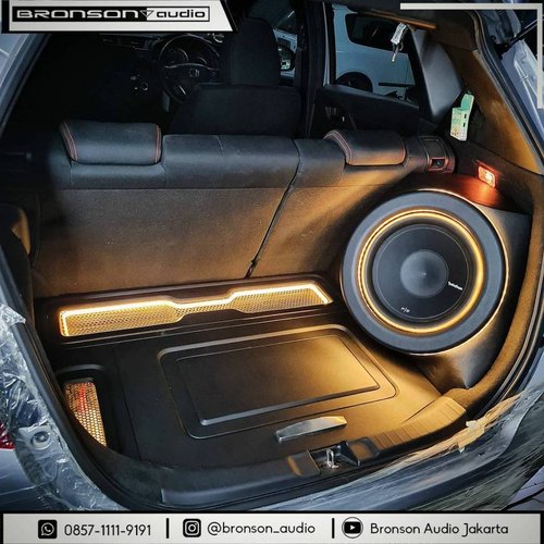

Attemping something like this

timelapse wrote:Attemping something like this
The regular PA grille should be fine. Maybe you can try pressing for the sub as well to match!

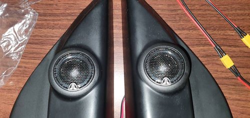

Fellas, yall ever experience this. I have a pair of arc audio x2 tweeters, fs is 1500hz i believe, i have them crossed at 3.1khz on my 80prs. Gain set to give them rated 40rms of power ran in stereo. I noticed the left tweeter, at 25% volume plays a bit scratchy and very soft. Then if the volume is raised to 50% or higher, it plays fine, clean, warm and loud. However, if i drop the volume back to 25% it continues playing fine. Its like the tweeter needs a warm up lol, but it only happens with the left. Any ideas?

Jeremy09 wrote:Fellas, yall ever experience this. I have a pair of arc audio x2 tweeters, fs is 1500hz i believe, i have them crossed at 3.1khz on my 80prs. Gain set to give them rated 40rms of power ran in stereo. I noticed the left tweeter, at 25% volume plays a bit scratchy and very soft. Then if the volume is raised to 50% or higher, it plays fine, clean, warm and loud. However, if i drop the volume back to 25% it continues playing fine. Its like the tweeter needs a warm up lol, but it only happens with the left. Any ideas?
This is symptoms of a poor electrical connection or cold solder. Are there passive xover components on the circuit?

Postby Jeremy09 » November 30th, 2021, 9:45 am
Nope, its an active set up. Crossover set on the 80prs and ran off a jl jd 400.4 which is set to full pass. Amp is new, never repaired

Postby kavaninho » November 30th, 2021, 10:29 am
Jeremy09 wrote:
Do some checks and testing. If you are comfortable and certain it is not wiring you installed, start swapping RCAs on your amp and radio to see if the problem carries over to the right tweeter.

Postby Jeremy09 » November 30th, 2021, 11:43 am
kavaninho wrote:
Jeremy09 wrote:
Ill start with the jacks and work my way to the tweeter. Strange everything brought new about 2 months now. I noticed that it happens when it feels like also, not constantly

Postby timelapse » November 30th, 2021, 11:59 am
Jeremy09 wrote:
kavaninho wrote:
Jeremy09 wrote:
I had that problem recently.Was a cold solder on the tweeter itself.But I figured that out after I swapped speakers

Where you putting the tweets Kronik?I put my passive crossovers in the dash itself.I know the c2 crossovers hefty, so I hear you
Posts: 9323
Re: Budget 6.5/ Now car audio advice thread
Postby *KRONIK* » December 2nd, 2021, 7:27 pm
timelapse wrote:Where you putting the tweets Kronik?I put my passive crossovers in the dash itself.I know the c2 crossovers hefty, so I hear you
I already cut the sail panel finisher and installed the flush mount cups
My dash dont have much space, so i think somewhere in the door is 1st option
david12
Posts: 784
Postby david12 » December 2nd, 2021, 8:21 pm
That look sweet boy Kronik!
Where you mounting the amp?
Usually I mount my passives by the amp if there is enough space. Of course this is relative to how far the amp is from my speaker wires. I would rather run 2 long wires than 4 when using passive xovers.
