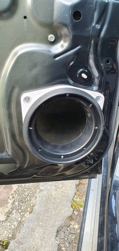

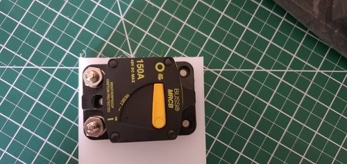

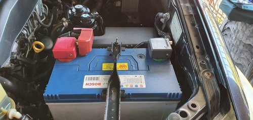

It started off as a 12v accessory system
I figured, if i hadda bring a current wire in the cab, may as well put a size big enough to support an amp (in the future)
And i am perfectly capable of handling the majority of the install.
Pioneer NEX series deck is already installed.
I already drilled off the rivets on the doors
Installed stainless steel rivnuts
Sourced PVC risers/adapters from LSC
Installed NVX silicone baffles
Backed the risers with closed cell foam (for vibration)
I already made up a harness (soldered, heat shrink, tesatape) with speedwire and a Metra dash harness.
I know the best things is to run fresh wires, but i wont do that until the van is repainted, then i will do new wires from amp to speaker and full sound deadening.
I even have the speakers installed in the risers already.
I buy harness adapters for the doors, so i wont have to cut the OE speaker plug. Will cut and extend the adapter instead.
As for the front, i just need a location to mount the passive crossover.
Sail panels have been cut and modified to accept the new tweeters. Those are installed already.
RCAs have been labelled
My biggest hurdles are to build a rack under the seat to accept the current wire to a distribution block and wire the 12v system and amp.
2nd hurdle is that i no wood work skill....at all.
So i prefer not to waste time trying to do that
...i prefer pay for that service.
3rd is the box....i was looking at a design with a bottom slot port. Also looking at incorporating the amp behind the seat, near the box.
Back to previous point, i dont know much about box building/tuning etc.
Hence i opted to have someone experienced do it.
Finally, i just need the speakers check to make sure i wire the polarities correct and i think i go be good dey.
Was considering adding an epicentre, but thats neither here nor there ATM.

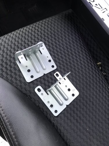

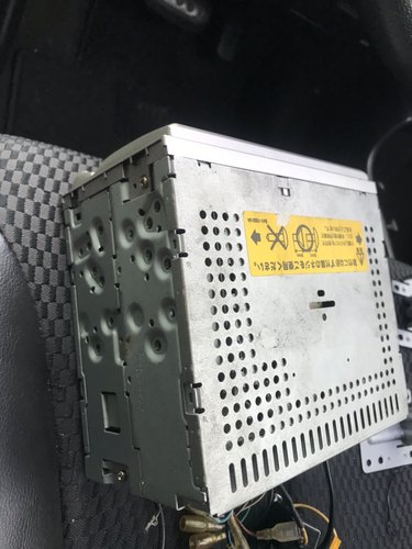

Postby eitech » November 27th, 2021, 2:20 pm
kavaninho wrote:eitech, do it yourself. It is super easy. Just get the harness and antenna adapter as Rovin recommended (wires will match up with like colours). Get the universal pocket if you are not going back with a 2 din unit.
iirc tiida harnesses does not have the ground in them so you may need to just tie the wire from the radio plug to the vehicle chassis.
Look at a few youtube vids and you will be ok.
Got the deck today and trying the install. Hooked up the electrical and everything works fine. Jus the physical installation am having trouble with. The original deck was mounted via two factory brackets on the dash. It has a metallic enclosure which seems pretty much apart of the deck design and separation doesn’t seem possible so far.
What do I need to do at this point?

Postby timelapse » November 27th, 2021, 2:31 pm
Dem brackets supposed to be universal.Once you line up 2 screws on each side of the deck with the brackets,you should be good.If not, drill your own holes

Yea it had the original sleeve on the deck i had to remove first then the brackets lined up. Now finish. The finishers not 100 but looks good as is. It space real close to install the finishers

Postby Rovin » November 27th, 2021, 6:52 pm
brackets usually have a L or R stamped on each to indicate left or right so if u mix them up things may not line up ...

Postby eitech » November 28th, 2021, 5:50 am
The L brackets weren’t the initial problem. The original deck has a sleeve which when removed allows for the L bracket holes to align with the deck for mounting. I got through there.

Advice time again....
Since i'm gonna have to remove my door speakers when the van goes to paint, i wanted to male the speakers "servicable"
Hence the use of rivnuts for the install of the riser....
So what is best practice for wiring to the speaker?
Should i:
1) use the crimp on terminals the speakers came with? (These are open ended)
2) use new open barrel spade connectors? (These are insulated at the end)
3) solder in a XT30 connector to the speaker and 1 to the wire so its just 1 jack to take off/plug back

Go for the XT30 connectors once available. These hold very tightly and you can disconnect as much as you like.

Nice, i got enough to do all 4 doors and the tweeters
So, thats my project for today

Postby timelapse » November 28th, 2021, 11:55 am
You using your door baffles I hope.... Kronik.If you are, I would recommend putting them under the riser if you using risers

Yes
I using the NVX silicone baffles
Not the Install bay ones.

System plans are:
Front: JL audio C2 components
Rear: JL audio C2 coaxials
SUB: JL audio 10" TW3D4 with sub grill.
Amp: JL audio RD900/5
Already have the KnuConceptz battery terminals installed, and i made up a fresh 0awg body ground with XS OFC wire.
Want to use a BlueSea Systems marine 150A breaker....but i aint figure out where to mount that

Postby Rovin » November 28th, 2021, 1:43 pm
nice choice going with d JL stuff 8-)
u watch dean & fernando on YT aka 5 star car stereo ? , they usually use d batt clamp bolt sticking up there in ur pic to mount fuse holder though i cant recall seeing them use breakers but is d same principle or they wud use rivnuts to attach it onto d vehicles body, always try to keep it close to d batt as possible since d wire between fuse holder\breaker & batt will be live\unprotected ...

The reason i chose the breaker, because i'm doing a dual electrical output.
80amps to the JL amp
80amps to a 12V bussman RTMR for all my future electrical needs.
The breaker is my 1st stage protection and can serve as a full OFF switch.
Then under the seat, i will use a fused distribution block to the amp and RTMR.
So i was trying to figure out a mounting solution to keep that breaker close to the battery as you mentioned.
I am trying to avoid drilling holes in the vehicle. So i looking to make some sort of bracket i can attach to already existing bolts (i hope)
