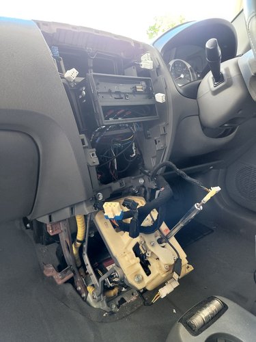

When you start pulling the console fascia to deal with a loose cable and a flipping screw falls into the shifter mechanism...
Re: Random Stuff in Car Audio ...
Postby Rovin » October 18th, 2022, 10:18 am
it happens & sometimes u cant find it ...
Brian Steele
Posts: 877
Joined: December 3rd, 2009, 5:37 pm
Postby Brian Steele » October 18th, 2022, 11:16 am

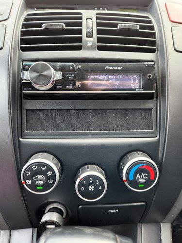

With the Tucson, it is actually easier to remove the dress panels around the shifter than it is to remove the console fascia. But I've done it so many times now that I could probably do it blindfolded now.
In the picture you can see the RCA cables from the ESX DSP that I have mounted in the dash below the deck. 1 ft. cables, six of them, that connect the desk to the DSP. The DSP has optical in capability, but the deck (an 80PRS) does not have optical out, so...
I was debating putting some fanciness in the dash to show of the DSP lights, but then reminded myself that my install is supposed to be a stealth install, so....
