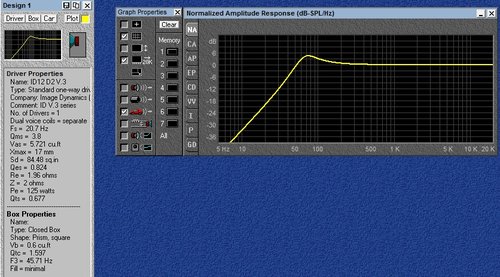

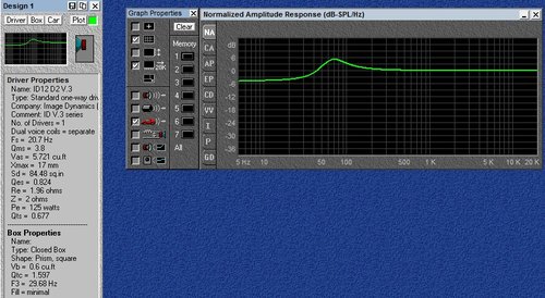

I'd like to ask a favor for anyone willing... I'm not in a position to install WinISD where I am.
Is anyone able to plot the specs of the ID12 D2 and post a screenshot of the graph with a 0.6 cu ft enclosure (not including speaker displacement)?
Speaker specs:
http://docs.wixstatic.com/ugd/d53db0_1e ... 037046.pdf
The D2 is on the second page.
evolution7tt
Posts: 759
Joined: October 21st, 2003, 12:56 pm
Re: Subwoofer for small space?
Postby evolution7tt » November 15th, 2018, 8:03 am
Two plots here
One for In car.
The other for out of car response.
DJ Q
Posts: 3371
Location: Awesome
Postby DJ Q » November 15th, 2018, 1:30 pm
Well that doesn't look too bad. I can EQ out that peak easily.
Thanks very much evo

evolution7tt wrote:Two plots here
One for In car.
You used something to simulate the room size it in to get that bump there?
evolution7tt
Posts: 759
Postby evolution7tt » November 16th, 2018, 9:34 am
The in car response graph is based on the generalized cabin gain that BB6 suggests starting from 50Hz.

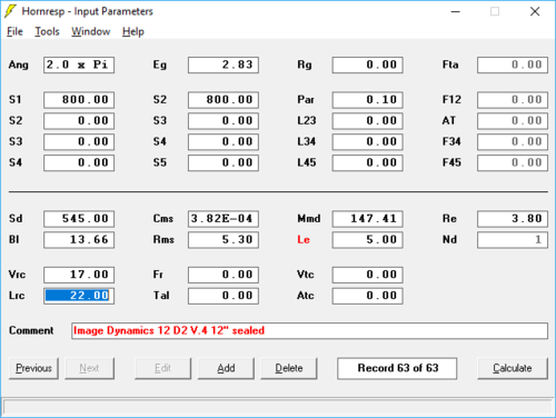

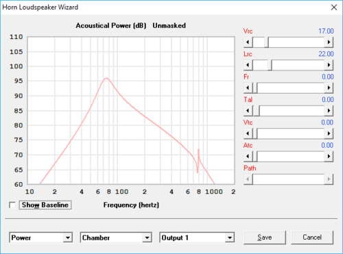

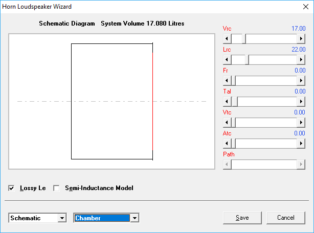

Postby Brian Steele » November 19th, 2018, 8:27 pm
evolution7tt wrote:If possible, can you post a graph that takes Le into account? I'm familiar with using BB6, but I've heard that Hornresp is more accurate.
At least we can then see how it compares to the BB6 model.
Unfortunately Le isn't provided with the published specs for that driver. It's likely somewhere around 2~3 mH per coil, so you can assume that value for your model of 5 mH with the coils in series. Also, there's no actual impedance data that can be used to derive the semi-inductance parameters. Using the "Lossy Le" option in Hornresp will get you close though.
So, here's the Hornresp input for the model, and the predicted response curve in 2PI space using a 0.6 cu.ft. box. In car, expect a lift at low frequencies, of course.
2018-11-19 (4).png (10.09 KiB) Viewed 12287 times
