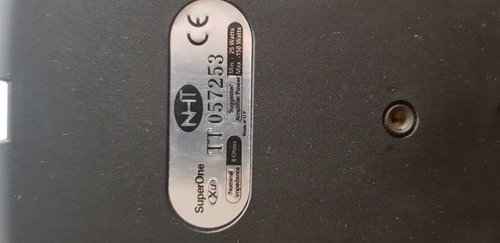

Reference speakers still going strong
SR
Chief Cook & Instigator
Posts: 13958
Re: Post Your Home Reference System
Postby SR » September 21st, 2018, 9:11 pm
SR wrote:Reference speakers still going strong
Old school

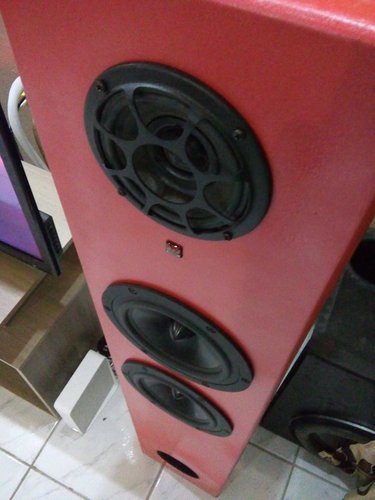

evolution7tt
Posts: 759
Joined: October 21st, 2003, 12:56 pm
Postby evolution7tt » September 24th, 2018, 12:22 pm
Morel Integra Ovation 4
Dayton RS180
Elektra SW12
