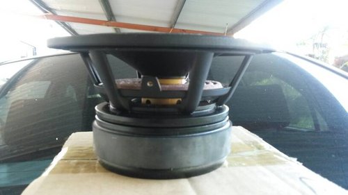

Postby X_Factor » February 28th, 2018, 8:56 am
a new toy to play with
5.25 inch xbl motor 9mm xmax

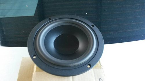

Re: Small Car audio build--(Sq)--rebuild time
Postby nervewrecker » March 1st, 2018, 5:31 am
Is that an exodus anarchy?
Postby X_Factor » March 1st, 2018, 6:41 am
yep
Postby nervewrecker » March 1st, 2018, 6:44 am
How much did they cost you landed?
I wanna try a set also. Just havent gotten the time to order em yet
Postby X_Factor » March 1st, 2018, 11:06 am
those cost 300 to ship and clear via seabox those lil things weighed 10 lbs and 3 inches mounting depth
ithe 6.5 will be more so make sure that u hav the mounting depth
Postby X_Factor » March 3rd, 2018, 12:45 pm
car doors
hadda do a 1 inch baffle so it wont hit the glass..
also hope th door upholstery would go on with that size of baffle as well
but yeah when its done no probs
Postby X_Factor » March 3rd, 2018, 11:19 pm
hoss
I now finished putting in one...and all i can say is WOW!! you would be happy!!
with a 1 inch baffle the window barely passes the magnet like 1 cm clearance
thank god the upholstery was able to mount back without issues
Postby X_Factor » March 4th, 2018, 3:48 pm
so they are installed
have them crossed 50@18db up to 3k and highs from 3k up
midbass awesome, techno type songs, insane
actual midrange not as defined and clear (sounds a bit thin) compared to the dls ultimate they are replacing
but i expected that to be the case
with a decent deck like a 80prs with a good eq i am sure you can get it to sound better
i am contented with them...its a good speaker for a good price
