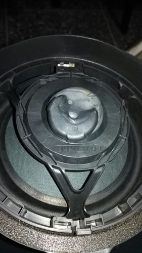

After replacing the Deck i was troubled when i couldn't hear any sound coming from the Front Left Speaker and was still hearing similar outbursts from the front right speaker. I inspected the front speakers and found that the Left was burnt. Since i had to replace it i decided to just replace the front pair.

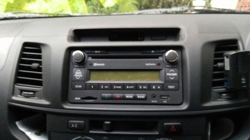

Original Deck...It is a Clarion Unit...however I am unsure if this unit was installed by a third party before being delivered to me as there was already an antenna adapter wired in when I installed my Pioneer Head unit
Melted Speaker...Yes it is mainly plastic

I did a lil recon by pulling out the deck to inspect the wiring behind and noticed the antenna adapter wired in also...mine looked factory so i dunno...
