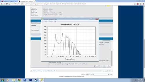

good day tuners i recently bought a SKAR Audio VVX-8 D2 plan on building a t line box looked all over d internet for a t line box software but did find any but i found a formula but is to hard to calculate some off d ts Parameters of the sub is
(Fs) 45 Hz
(Vas) 5.8 liters
(Qts) 0.65
(Qes) 0.75
(Re) 2.0 ohms
(Qms) 4.80
Maximum Ported Box Volume 0.75 cubic feet
now i no T line box are large but if i could get it small version it will be best cuz im tight on trunk space,want it tune to about 35-40hz
so if some one could help me design this box it will be grate-full thanks

Your 'tuning' will be the resonant freq of the driver , 45hz in a t line.
Unfortunately, this driver is completely unsuitable for a t line. Parameters are way off.
This is what it looks like. You can build it if you like, its a standard constant cross section of 240 sq cm @ 200 cm long. You can try to eq it into submission, but your better off with a standard ported enclosure.

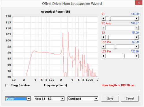

The problem here is that the volume of the TL (and therefore the cross-sectional area, length and taper of the TL) is proportional to the driver's Vas, not Sd (cone area). This is why I can say with some certainty that TLs designed with cone area being used to determine the TL's cross-sectional area are not properly designed. Old TL theory, which was subsequently shown to be incorrect, used cone area as the determining factor, but work done by Martin King has shown that the volume of the line is dependent on Vas.
And here's the issue with this particular driver - the Vas is very low, making the design of a good TL for it near impossible to achieve in practice.
For example, consider this offset-driver TL alignment for the SKAR Audio VVX-8 D2 (I guessed a few parameters, Le and Sd, as they were not given). On paper it looks good, but when you try to fold it into a box, it's too small to fit the driver.

It looks like you already tried it using the parameters of the Skar Audio driver and it did not work well. It's not because the driver was "unsuitable", it's because the classical TL approach of just looking at Sd and Fs ignores or does not account for the other driver parameters that basically define its behaviour, so it is inherently flawed. Martin's approach takes all of these parameters into consideration, so it is more accurate. It just so happens that in this case it's difficult to design a TL with a flat passband for this driver that can actually be built because the Vas is so low.
meccalli wrote:Bjorn on diy always designs mltl's but I don't see the difference being significant to a 4th order ported. An mltl is practically your standard quarter wave tube with a *port.
There is a big difference. IMO MLTLs and TQWTs are attempts to keep the advantages of a TL (e.g. extended low frequency response) and resolve the problems caused within the passband at higher resonance frequencies in the TL (a "straight" (constant or near-constant cross-section) TL is actually the worst performer in this regard). By moving those response aberrations higher in frequency, they are easier to deal with via lining or stuffing the TL.

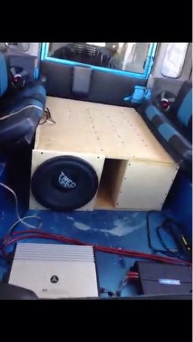

Will 2 Treo 1244 SSi work in T line
Bass box pro 6 only suggesting seal enclosures for this sub because of low (EPB) not sure if I got acronym correct
Any thoughts?

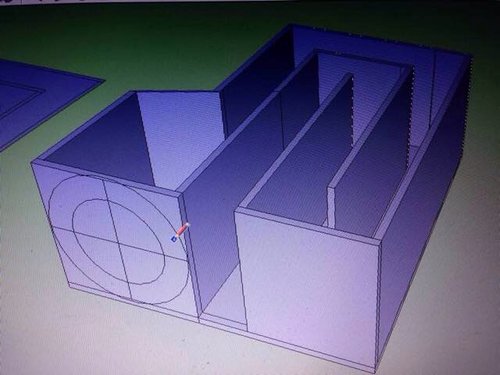

Postby Pablo660 » February 26th, 2015, 6:17 pm
playing with sketchup

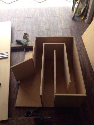

Postby Pablo660 » March 2nd, 2015, 6:52 am
I built this and it sounds ok, running a JL G4500 to test out
I will keep an eye out for the over excursion
