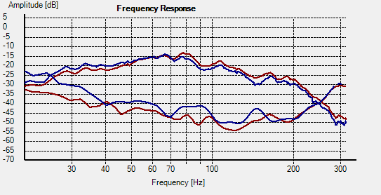

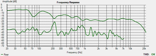

SR wrote:Electronic equipment sucjlh as the industry standard audio control 3056 rta can only go so far as to measuring actual bandwidth of the system but it cant detect distortion. Distortion measurements can be done freq by freq with a scope however its different when reproducing multiple frequencies at the same time
Distortion measurement (well, except perhaps for IMD) is pretty easy to measure these days. HolmImpulse is free - all you need to do is provide the PC and mic. In fact, I'd say that it should be a requirement to measure distortion when choosing x-over points for your drivers (e.g. a tweeter with too low an x-over point will show a lot more measurable distortion than one with the x-over properly set to match its characteristics. Distortion measurements are also a great way to quantify the impact things like panel flex have on the overall sound quality of your system.
Some images for you as these speak louder than words
Distortion curve - car response
1. Distortion measurement done on my vehicle while I was still tuning it. See that peak @ 200Hz? Combination of panel flex and severe resonance at that point. Subsequently tracked down and eliminated. Of interest here is that the measured distortion at bass frequencies is less than or equal to the rest of the spectrum
Distortion curves - subwoofers
2. Distortion comparison between two subwoofers. In red is the response of the Alpine Type-R 12". Guess which one sounded cleaner?
Distortion curves - tweeters
3. Distortion measurements on a cheap 2x5 Goldwood piezo tweeter, before (blue) and after (red) the use of a shaping filter. It should be easy to deduce from the graph why these cheap piezos sound like ass if run anywhere below 4.5kHz or thereabouts. So much for the talk that you can "run them without a crossover"!
