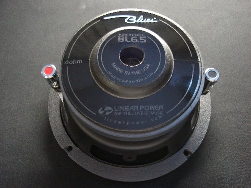

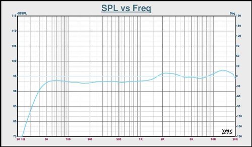

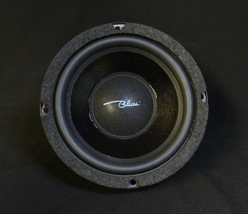

Postby SQ Audio » January 31st, 2013, 11:44 pm
Try a pair of these up front in your doors properly well dampened...BOOM! in ya face :D
