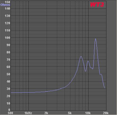

Postby Brian Steele » March 1st, 2012, 7:32 pm
TEAM ADT wrote:.The higher notes can be easlily reproduced through a single pair of Power Acoustik NB1 tweeters.
Umm...
TEAM ADT wrote:For your tweeters, get two pairs of 25w 15ohm resistors, connect them in parallel, and then add a metalized polypropylene capacitor (the yellow round ones) in series to the resistors, the value should be anywhere from 3.3uf to 4.5uf, with a 50v to 100v rating.This would be for each tweeter, and would give a 7.5ohm load present, while only allowing around 25-25watts rms to run to them.This would also create a small passive crossover allowing only frequencies around 2.5khz and up to go to them.
This is based on their quoted or measured impedance?
I have a pair of NB1 "clones". If the NB1s are built the same way, there's a cheap small electrolytic capacitor hidden in the base. Even with it bypassed, the impedance measures a minimum of 25 Ohms, rising up to 60 Ohms and over from 7.kHz or so. If I was planning to use this, I'd bypass the internal cap, put a 4-ohm (or even 2 Ohm!) resistor across the terminals at least, then hook it up to a xover that'd designed around a 4 (or 2) ohm terminating impedance. And I definitely would not use it below 6~ 8 kHz, as the impedance curve suggest you're going below its resonance at lower frequencies.

Postby Brian Steele » March 2nd, 2012, 7:26 am
TEAM ADT wrote:My advice is based on "manufacturer specifications" of the said product.
TEAM ADT wrote:While yes I can agree with your statements, real world application states otherwise. The NB1 and eminence alfa have been proven combination in many vehicles in both sound and output.
See comments from SR about their perceived quality. While this is likely partly due to the tweeters themselves, it could also be due to improper crossover configurations, e.g. a great way to get distortion out of a tweeter and make it sound horrible is to drive it below its resonance point by using a high-pass filter at too low a frequency and/or too low an attenuation rate.
