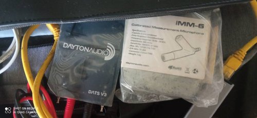

Got the laptop and accounts running. I will get the REW and DATS software set up in a Lil timing.
When Ramadan done I will try out the various t line configs... With graphs!

Postby ruffneck_12 » April 11th, 2023, 9:09 am
the dats very good for other things as well
You can use it to measure inductors and capacitors and whole crossover networks an ting
Also can test rub and buzz on speakers
Also Rovin it wud be a good tool for you to see if speakers are still within spec (although the manu spec and the pre-broken in spec would be vastly different)

i agree with d dats is great to have if u want to be very specific, however i dont build boxes for random ppl with used subs & brands i dont carry, i only build for brand new subs bought from my store so those factory t\s specs are good enough for my purpose
cc1 great to confirm what ur trying to do especially if ur not using digital processing & using those dials on d amp that are not very precisely marked to set up crossover points
dd1 takes all d guesswork to prevent u clipping ur amp & fuggin up ur speakers & amps
a professional RTA also a great tool too so u wont have like a drastic 18-24dbs peak\valley but at d end of d day most ppl wont want a near 3-6dbs RTA flattish tune, they just want well turn this\that buttons up\down til it sounds good to their ears
for ur own personal use all are great tools to have once u can afford them ... if u have family\friends coming from d usa bringing it as gifts u will save a bunch of $ from s\h & taxes
Re: Which sub fow lows?
Postby ruffneck_12 » April 12th, 2023, 10:49 am
I got a good dbx RTA mic, love that lil bugger .I hardly use it but I love it :lol:
Also got the same IMM6 mic as smash at first . its aight . Kinda cool for audio recordings in general too. Used it for phone calls too :lol:

Postby sMASH » April 12th, 2023, 7:07 pm
ruffneck_12 wrote:I got a good dbx RTA mic, love that lil bugger .I hardly use it but I love it
I will try it, my fone mic is crap.
Always wanted to try it. But for years I wasn't finding it.
