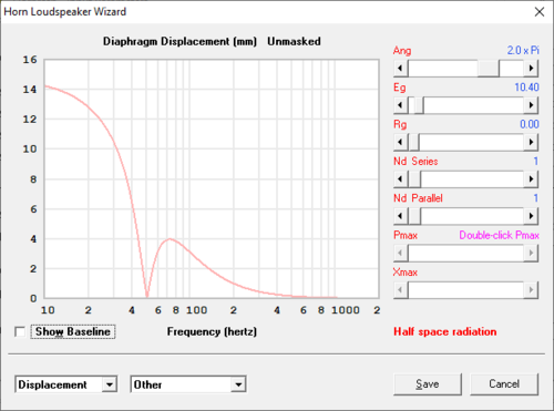

Postby Brian Steele » October 19th, 2022, 7:14 pm
This is what the driver's excursion looks like in a vented box. Notice that, while excursion increases below Fb (50 Hz in this case, the driver is still within its excursion limits (5mm) down to about 42 Hz. This suggests that the HP filter can be set at 42 Hz or even slightly lower, depending on how steep the HP filter is.
And this is a theoretical situation. In practice, excursion will be less linear at higher power levels and you could likely get by with an even lower HP filter frequency.
