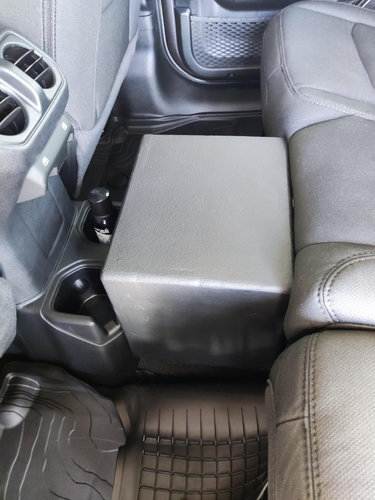

Recently did a small install that actually blew me away... 3 way active Front stage SQ oriented.

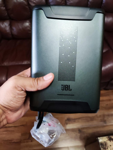

JBL DSP4086 DSP Amplifier
Hertz DT24.3 Tweeters
DLS 2.5" Dome midranges (had these in storage for 12 years)
Stock 4" Mid bass (actually sounded so good didn't bother to change them)
ARC Audio 8" sub in a very small sealed box

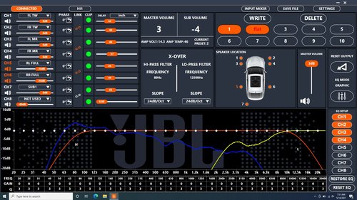

Amp is 40Wx8 into 4 Ohms and 60Wx8 into 8 Ohms. Full 8 ch DSP with all the bells and whistles. Using it for everything including the sub...lol
Ended up using one channel each on each 2 Ohm voice coil for about 120 RMS on the sub.
I must say, that little JBL blew my mind. No distortion, lots of control, loads of power and the thing is small.
The only drawback is a little floor noise. Have to check the grounding to see if I need better connection. Also there are no terminals, its all in a harness so a lot of solder, heat shrink etc.
I may upgrade the tweeters. Not sure yet, because they sound very good, just the entry line model.
The ARC Audio sub however is a real little monster. FS is 22HZ and trust me it plays very low for an 8". Its rated 150W so the 120W is just enough juice.
Box is 0.3 cu ft. Built with pitch pine, wasn't feeling to buy an entire sheet of MDF to build such a small box.
The couple persons I demoed the install to were all fascinated.
The Head Unit is the stock unit, using a PAC interface with Applemusic and Spotify. Stock HU plays HiRes FLAC files also.
These DSP amps just keep getting better and better. The JBL was rather inexpensive, but very worth it for what it can do.

Yeah boy... its a JEEP Wrangler... the output on the stock speakers surprised me. Its also a pain in the butt to remove the stock midbasses and their enclosures (yes they are installed in enclosures).
There is a Metra replacement pod to fit a 6.5". Might consider it sometime in the future.

The DSP is great for the price point. Only thing I can complain about is the slight floor noise (trying to narrow it down to the DSP or the interface module).
Also the remote bass knob is not the best... could be a little more linear and of a better build quality.
I ended up "painting" the sub box with flex seal spray. Surprisingly the finish was quite good and matched the rugged look of the interior of the vehicle. The placement kinda hides it so you don't really know its a sub.

The GUI is fairly easy to navigate and use... only nagging issue is the sliders have no incremental step click adjustments. So you have to take your time and slide with your mouse...

An the best part is that you can adjust the outputs all the way down to -50dB and use it as a preamp/dsp and add external amplifiers for more power. This can be done for 1-8 channels. So for example you can use the JBL for powered output for tweeters and midrange. Turn down the output for the mid and sub bass and add external amps for more power to those channels.
They also give you some neat terminal to RCA adapters for this purpose... pretty neat

To be honest I was not expecting the output to be sufficient especially for the Jeep environment. But after the initial install I never had the need for more power. I know you have to factor in the drivers and the sensitivity also.
The sub is what was unexpectedly surprising. A very small sealed enclosure and very good output with excellent freq response. Each 2 Ohm voice coil on a channel should give it 120W rms...
