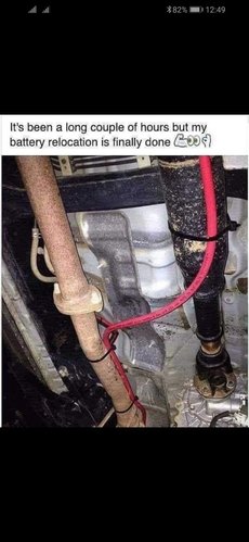

Why does this look like underneath a Hilux
*KRONIK* wrote:
OP check and make sure he didnt do this too

kamakazi wrote:Why does this look like underneath a Hilux
Lol
Nah
FB pic...

I eh know what worse the wire zip tied to the exhaust or the driveshaft
Lol
That pic just cringe-worthy

I once made a rookie mistake like that in the earlies.I ran a 4 gauge through my car and tie strapped it to the handbrake housing.Ended up obstructing the proper operation of the handbrake.Fixed it immediately.But that's me being a noob.These fellas are professionals...

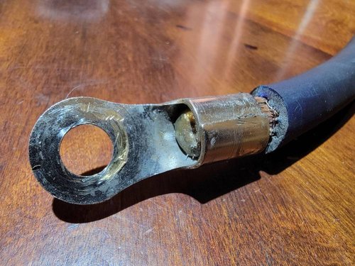

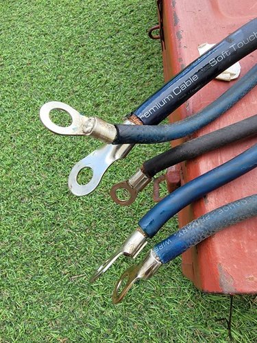

sickbad
Posts: 166
Joined: July 29th, 2012, 8:59 pm
Re: audio installers who cut corners
Postby sickbad » April 3rd, 2022, 11:12 am
Let us not forget. Big three with 4 gauge CCA. Courtesy Joel Khan, chaguanas. If you have dealt with this person. Check your install maybe you overpaid for uncrimped connections and inferior materials. Looks like he tried to crimp with a pliers.. wires dem a loose

sickbad wrote:Let us not forget. Big three with 4 gauge CCA. Courtesy Joel Khan, chaguanas. If you have dealt with this person. Check your install maybe you overpaid for uncrimped connections and inferior materials. Looks like he tried to crimp with a pliers.. wires dem a loose
Jaysus.Not even in a vice.That is definitely pliers 'crimp'.

Jerry84 wrote:Mr Joel Khan or whatever his name is, is a crooked businessman who rips off people who work hard for their money.
wow. thanks for your contribution, he did use used wire, hidden in nylon wrap.

ive taken 3 vehicles to JOEL way back prior 2015 on referral. Who says a consumer should not have to go through his work?
i was sold copper and given CCA, used CCA also. again, keep your materials at cost price. gopauls and other shops in chagauans are very competitive, you were right, best to do it myself.
timelapse thank you for being a major contributor/critic on JOEL KHANS work, not even a vice grip for crimp etc.
