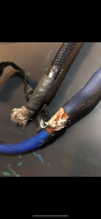

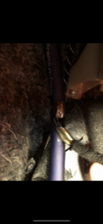

I had a chance to assess my install and i've found:
0 gauge front to back CCA hidden in nylon braided wrap
old house lamp wire taped up in electrical tape (tapped into the 0 gauge under the dash)
joined used-wire for my amplifier again hidden in wrap.. everything looked pretty
this was after the installer was preaching that my system needed full copper this and that.
frankly, he talks too much charged thousands of dollars and kept my car for a full week.
Does this happen alot? why he would choose to rip off customers, to pay his bills?
I am pissed. don't know how to approach the situation. do we let forever be or attack with full force?
is it worth a few thousand dollars.. the stress, retribution ?
I've had to visit other installers and done over the work myself, of which I am grateful for learning the craft.
-but really? took me a few weeks to get copper, crimp, feruls, shrink stuff that this experienced person who says he owned a store could not acquire in all the grey hairs on his head? Do i see it as a really expensive lesson : metaphoically, litterally, financially ?
lord put a hand.
installer if you are reading this - shame on you, ironically you take advantage of people as they do not understand electronics. You cannot practice the craft and call yourself a professional when behind the books cover, you hide the same inferior materials you told the customer to stay away from. You are really an embarrassment to yourself through your work and the establishment who graciously sends you work. income. bread and butter for the family.

sickbad
Posts: 166
Joined: July 29th, 2012, 8:59 pm
Re: audio installers who cut corners
Postby sickbad » November 10th, 2021, 8:42 am
story goes.
i acquired a ztreet 4chan, zap2000 from a ttuner and xtr6.5 and 6x9 with entry level pioneer deck in retail store ( all from trinituner links)
installer quotes $1800 labour and $2000 supplies. after all i need full copper and a few sound deadnening mats are expensive he could get a whole box of deadner for $1000 (included in accessory expense)
on his advice i returned the deck and got a new one online, installer said retail store is waste of time and he could source product cheaper for me, himself.
i also got a battery for $1200 as i have a stock alternator.
towards the end of the job he ran out of accessory money and needed $500 for more "full copper"
I bought a used RE12" and equalizer for $2000 for him. the EQ was scrapped because it interferred with the DSP. not the best guidance as he recommended kenwood for tonnes of features. little did he know the EQ would just work with 2 channels.

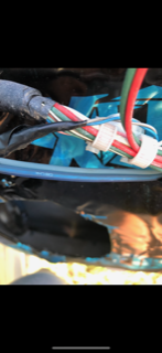

ISSUES:
    i was peeved that the Ga wire used was 16Ga, after all 90RMS and 180RMS speakers need something like 14, or 12 Ga. he ran the speaker wire to the front harness (toyora 22Ga : to slip through the door and attached a 8" piece of 16Ga to the speaker? he soldered all wires to speaker terminals, no clips.
    the power wire from the 2nd batter to the 4channel was 2x4Ga wires soldered in the middle, taped up good and made pretty with nylon wrap.
    the 2 front doors and only trunk lid have deadener, don't know if that is a "whole box" that he got afterall.
    he cut the cca 0 gauge coming from the engine bay to power the deck with house lamp wire.
    i discovered yesterday that the only piece of material that could have value front to back was infact cca in nylon it has that cheap light non copper weight to it.
he does not pick up my calls. i have a question about a random wires on the install that i do not know is for. so yea gave him $6100 for the labour supplies used sub w ox and used EQ
so far ive spend a couple hundred in full copper proper gauge speaker wire, ran it through the doors myself, fresh 0 OFC for the amplifiers. will have to get that full front to back run in OFC to right his wrongs.

sickbad
Posts: 166
Postby sickbad » November 10th, 2021, 4:18 pm
JOEL KHAN #caraudio #subwoofer #audio #bass #audiomobil #carstereo #caraudiofab #caraudiofabrication #car #caraudiosystem #spl #basshead #soundquality #customcaraudio #pioneer #caraudioinstallation #sound #music #volt #audiocar #speaker #subwoofers #caraudioaddicts #v #lowbass #aintloud #sundownaudio #loudsound #bhfyp
#cars #amplifier #stetsom #ddaudio #woofergram #deafbonce #loud #jlaudio #customaudio #chuchero #pridecaraudio #midrange #rockfordfosgate #soundigital #soundsystem #prvaudio #alphard #caraudioworld #dbdrag #custom #ds #kenwood #speakers #woofer #caraudiolife #jbl
, referred by Rovin. ironic because the installer was trying to undermine the same person who sends him business.
have a look at the oem harness and a little 16Ga tail. who is he fooling . could a 90RMS speaker get proper feed from 16Ga to 22Ga to 16Ga..
theres the 4Ga splice solder.
lamp wire tap into 0 ga CCA under the dash.
and frayed ends, which he says he solders instead of feruls.

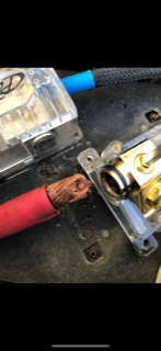

sickbad
Posts: 166
Postby sickbad » November 13th, 2021, 5:25 am
its like putting a sock in yuh jockeys.
MORE cheap 4Ga CCA with nylon braided.. looks almost like a 0Ga. Really wonder how people could sleep knowing they are talking to the customer premium and giving him pauper.
so maybe I have the grounding surface area of a BIG 2.
the only items of value would be the nylon braided wrap. thanks JOEL 767-3291 for all your amateur car audio install efforts. time to hang up the hat, there are teenagers old who are more competent as we can see from the work.

one question i had about the wiring was .. he ran a speaker wire +&- from front to back. say + was the 12VDC remote for the monoblock and the 4channel. the other wire (i forgot to take pictures where it went) measures 0.2VDC which research says is the deckoutput, what would that wire possibly be for? grounded? i'm stumped.
To the pioneer deck man.. geeze at least yours was still a pioneer and not an fake with wireloom hiding his lies, shame and reputation
Posts: 8788
Postby timelapse » November 15th, 2021, 6:47 am
Possibly for power antenna if you have one, or he just used both the +- and connected to the amps.If that loose somewhere in there, you have a problem....

Running fresh cable through the doors ? Leave it for the for professionals. Need to save time ? Simply send your wiring to the oem harness because that goes through the doors ! Duh here is a step by step tutorial how we do things to make top dollar by Joel Khan
Need power on the jiffy? Store closed and you spent it all on perfume and the pastor?
Grab some lamp cord, make incisions where convenient and wrap up tight with electrical, Tesa tape, you can even use masking tape! The customer will never know.

Postby VexXx Dogg » December 9th, 2021, 11:10 am
OMFL, that man going to burn down somebody car.
