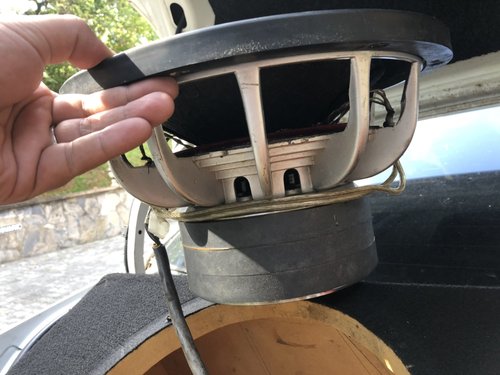

Join me on a car audio journey where we get a little obsessive. Will start with highlights of what was left from the installer, I will give jack his jacket-Looks nice, sounds good. But don’t judge a book by its cover. It may not be wired to be Zapco worthy or configured for XTR equipment.
We can make it better, with the help of fellow tuners. We will improve by just Doing It Yourself. We all have had some expensive lessons so maybe we can all learn from them!

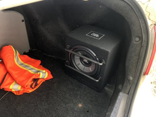

Initially wanted something compact, for bass. Liked the tube design, but imported this JBL self powered unit..

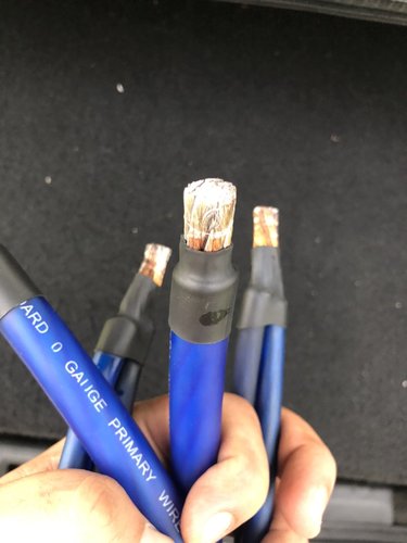

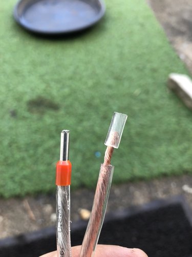

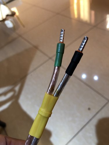

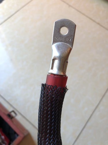

I tried to solder my tips.. on bad advice, lazy many ferrule .. Then heard it’s not the path of least resistance... Don’t be a frayed get the crimp and ferruls can be found locally!
10tonne hydraulic press for the bigger wires $35usd, square crimp goes up to 8AWG $20usd, (get the hexagonal one, similiar price),$5 assorted shrink wrap
He tried his best!
Tape it, then shrink it. Better to use a torch instead of a lighter. Lighter gets black stuff on your work!

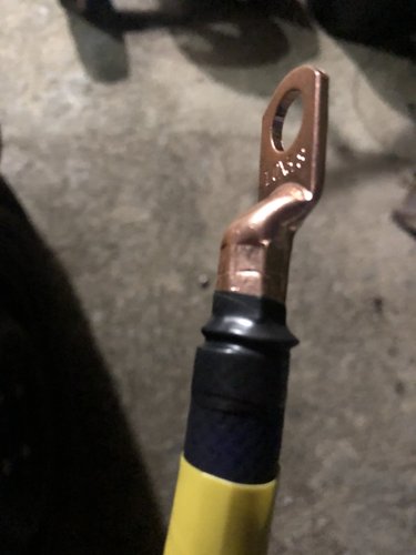

Changed all wires to “of course it’s copper” -OFC & 0 gauge ferruls to compliment. The hydraulic presses in the hex format.
Subwoofer leads and speaker wire. Do it right the first time!
Re: SQL sleeper
Postby X_Factor » November 22nd, 2021, 9:31 am

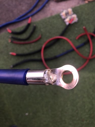

You can solder the regular ring terminals for 4g/0g but my process is
1) clean with alcohol and scuff the ring terminal with sand paper, dremel etc where the solder will be adhering
2) crimp terminal properly...not using a hammer and just pounding it flat
3) use a high temp solder iron..all that metal and wire has to get really hot for the solder to flow and bond properly...
I did use a piece of electrical tape on it before heat shrink but i noticed after a while the adhesive on the tape would fail and the heat shrink would eventually slide off
What is more important is sizing the heat shrink properly so that it really tightens over the wire
Or if someone is really ocd buy it with the adhesive on the inside

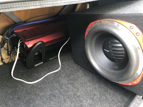

Sorry gents, no fiberglass, I’d consider it if the trunk was fully water sealed, and I have a donut in the front compartment, as it would make use of the wheel well space. Would need about 2.25 Cu . Thanks for the tips on soldering, the strands are so tight when pressed, don’t know if the extra strength is worth the additional tinning. Heard a good wire is only as good as it’s ends!
The attachment IMG_7331.JPG is no longer available

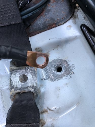

thanks Allie rat for the tip of engine to chassis grounding!

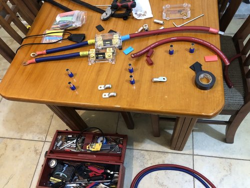

Did over some grounding in the back.. will use 0 gauge welding leads from modern electrical 27$ odd for 1/0 and 33$ for 2/0 .. I’ll have 2 runs of front to back 1/0 one for + and one for -.

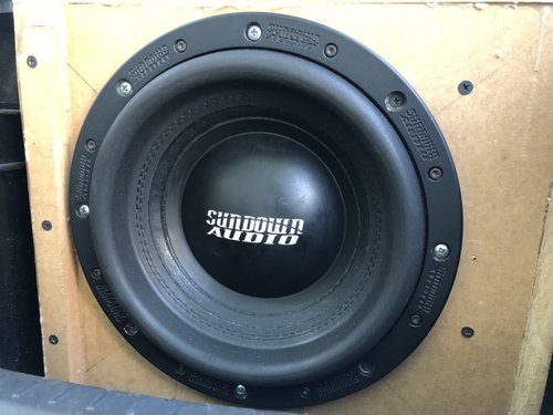

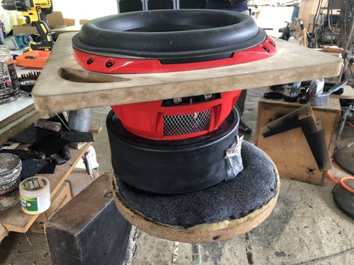

12” re xx .. was alright installer sold me in box for $2k.
Sundown x10 .. heard they are good, it was also $2k used
fell in love with the red woman.. Timmy from trini customs set me up with a 1” box to spec tuned to 30 lows? Also made an amp stand
real talent here

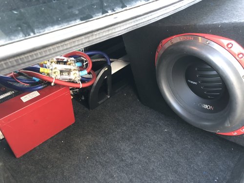

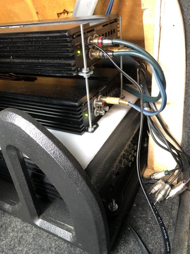

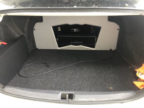

The sub is getting power from stacked zapcos St-2000 xmi II -3900W at 2ohms.
Orion XTX654
In the front doors and 2 more to be installed for the back powered by an Orion XTR 2000.4 .. really wanted headroom but suppose it could bridged -the 3rd and 4th channel to power 1000x1 and have 2 XTX in series at 800RMS.. but with no stereo/DSP
What else.. have some neo tweeters coming in the mix but would need another amp and maybe DSP to control the 6+ channels .. things getting expensive. Will have to address power soon

Thats bedliner on the amp rack?
Will it hold on fiberglass filler?
david12
Posts: 783
Re: SQL sleeper
Postby david12 » November 22nd, 2021, 8:34 pm
Could be this new thing, Duratex
