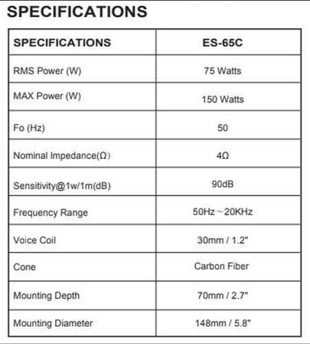

Already have equipment, pair of resilient sounds es65c and pair of arc audio silks on a jd 400.4 in stereo. I absolutely love how it sounds butt you know sometimes your may want to just get a little loud. Was wondering what i could do to be able to open the doors and get it sounding loud without changing equipment. Spec on the 6.5s attached

so if ur speakers rated 75 rms with a 50up freq response & amp is also 75 rms then it sounds like u need to tune ur eq settings ...

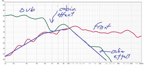

Postby Brian Steele » October 21st, 2021, 10:12 pm
Getting good midbass involves a lot more than choosing some arbitrary electrical x-over point for your front speakers. For example, the x-over points should be chosen to ensure that a good phase relationship is established between the subs and front speakers through the x-over region.
Posts: 8788
Re: Budget 6.5
Postby timelapse » October 22nd, 2021, 7:01 am

Postby kavaninho » October 22nd, 2021, 11:56 am
timelapse wrote:
Brian Steele wrote:Getting good midbass involves a lot more than choosing some arbitrary electrical x-over point for your front speakers. For example, the x-over points should be chosen to ensure that a good phase relationship is established between the subs and front speakers through the x-over region.
True enough.But x over point at 100 hz cutting off most of your midbass.Just saying
Dont get it wrong guys. Good midbass does not come from crossing the fronts super low, it comes from the relationship with the sub and woofers i.e. alignment, coherency etc. .
Car audio subs generally do not do well above 80Hz.

Postby Brian Steele » October 23rd, 2021, 2:27 pm
timelapse wrote:True enough.But x over point at 100 hz cutting off most of your midbass.Just saying
Midbass is that range between 80 and 500 Hz. If your ACOUSTIC x-over point for your speakers is at 100 Hz, then you may be losing some midbass. However in-car there is usually a BIG difference between the electrical x-over (what you said on your head-unit, DSP or amp) and the acoustic x-over (actual -3dB point in the midbass driver's measured output) because of the impact of the car's cabin on the response at low frequencies.
The problem with aiming for a lower cutoff point of 80 Hz for 6.5" midbass speakers is that they could run out of excursion at lower frequencies, particularly if you're like me and like to play music a bit loud on the weekends :-).
I've attached the current response curves for the subwoofer and front speakers in my car. There are two issues: one that I can deal with (the 200 Hz peak in the subwoofer's filtered response ) and one that I can't (the dip around 70 Hz). Well, I can theoretically deal with the latter by choosing a much lower x-over point for my 6.5" drivers, but then the system is going to sound like crap if it's turned up.
Anyway, the acoustic x-over point seems to be just above 100 Hz according to the measurements. Want to take a guess at what the electrical x-over points are for the subwoofer and the front speakers?
Re: Budget 6.5
Postby rollingstock » October 23rd, 2021, 4:41 pm
65 sub and 125 front?
Just a wild guess
Posts: 8788
Re: Budget 6.5"
Postby timelapse » October 23rd, 2021, 5:43 pm
100 hz sub im guessing.
