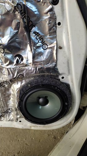

Review of JL Audio 6.5" C1 components powered off android deck power
i must say upfront that i am a dealer for these speakers but i will try to give an unbiased opinion
heard it a few hrs ago in a mazda 3 BM model , owner bought speakers from me & did his own install in stock speaker locations & tweeters on those triangle pieces behind side mirrors
owner is still tweaking\tuning , after 2 or 3 songs d way he had it set tweeter [which is metal dome] were a tad too rich for me so i asked him to lower 3 highs eq bands [cant remember exact hz] , sounded much better ..... then we tried random genres of music : needs some fine tuning but overall sounded very full, tight, rich, light & airy , for it being Jl's entry level series its very impressive for being on deck power
i suspect it cud have more midbass if they were put on an amp & sound deadening on doors , loudness is sufficient for most ppl but if u like very clean clear sounding music with even deck power it will satisfy ...
