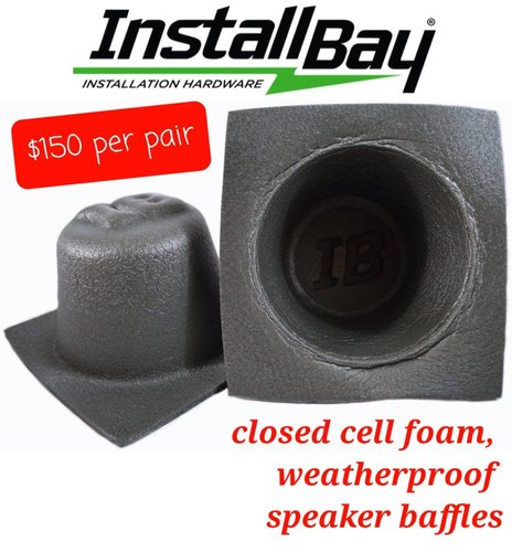

Postby *KRONIK* » November 14th, 2021, 4:24 pm
Just putting this here incase anyone interested
300 for the set of 4
PM if interested

in case anybody wants these weather cups i have both 6.5" & 6x9s which can fit around an 8" too ... $135\pair
