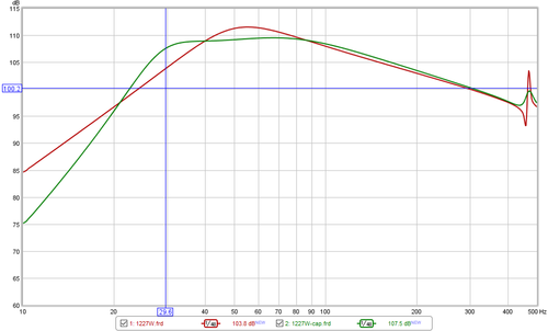

If you really want to try something different, have a look at passively-assisted sealed alignments. Basically you take a sealed Q~1.0 enclosure and put a good deal of capacitance in series with it. End result is a frequency response that's close to vented, without the vent. Box is small though, so you lose some efficiency (no free lunches here). Looks like a good match for cheap car audio subwoofers with their high inductance, but you'll have to model with Hornresp to determine what size box and the amount of capacitance needed to get the best results from a particular subwoofer.
