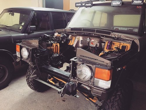

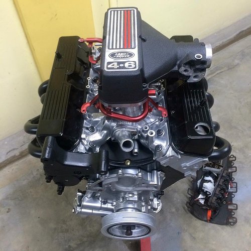

SUSPENSION
Heavy Duty adjustable panhard rod
Polybush polyurethane bush kit right around
Light weight 3 degree Castor Correction radius arm
Cranked rear trailing arms
Heavy duty steering rods
Heavy Duty 2" lowered Twin shock absorber turrets
Heavy duty 5mm front/rear spring retention plates
Front/Rear dislocation cones
Rear shock absorber mount dropper
2" front lift spings on 2" spring spacers (4" total lift)
3" 460lb/inch rear lift springs
Extended bump stops
3" extended length rear shock absorbers
2"extended lenght front shock absorber
Rear double shock install

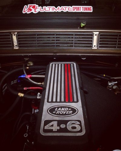

ENGINE
4.6L Range Rover H/C V8 EFI (S46D)
Hedman Hedders
Top hat liners
Stage 3 Pistons
Upgraded valves, lifters, rockers
Bosch Platinium +4 spark plugs
Roller Timing Chain Kit
Kent Competition Camshaft Kit
WALBRO high pressure fuel pump
Custom EFI regulated fuel rail
Davis Unified Ignition LiveWires
Dual Batteries
Ford Racing injectors
Aftermarket uprated coil pack W/ Haltech HPI4
Uprated Hi Torque starter motor
Split charge system
High volume oil pump with high pressure gears
ACCESSORIES
Painless Wiring full body harness

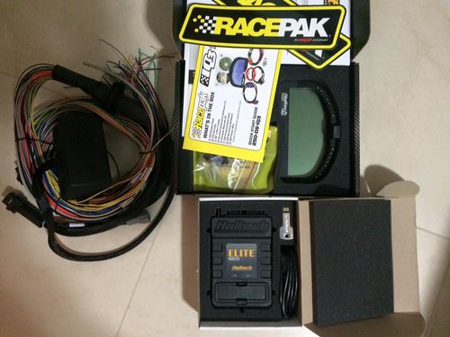

Haltech Elite 2500 standalone EMS

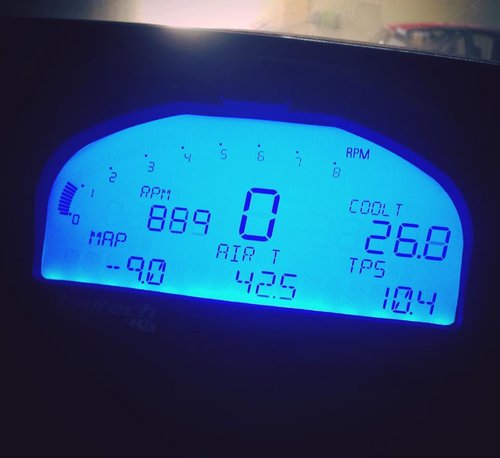

Haltech Racepak digital display dash
Haltech Dual Wideband Controller
BOSCH dual knock sensors
SPECTRE performance air filter
SPECTRE performance top radiator
Aftermarket coolant overflow bottle
Oil catch can
Dual electric fans
AEM oil pressure, water temp, oil temp, air temp, fuel pressure sensors
Mishimoto engine oil cooler
Mishimoto transmission oil cooler
HALTECH MAP sensor
12,000lbs Winch
OEM spec tow bar
Custom built winch bumper
Custom built light bar
Quad Hella 4x6" roof mounted spot lamps
Quad Hella bumper mounted fog lamps
Porsche X-Pipe
2.50'' Exhaust piping
Dual Flowmaster exhaust barrels
Magnaflow exhaust tips
NRG Grounding kit

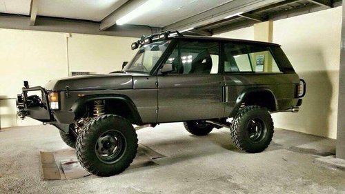

BODY/WHEELS
Custom Fiberglass bonnet
2'' Extended wheel arches
Reversed Discovery 16x7 Steel rims
265/75/16 Super Swamper IROK ND
Custom fiberglass snorkel

Nice! But question tho, how does that reversed rim work? I've always heard about it. Isit a matter of just turning the rim around or some mods have to be done?

hindian wrote:Nice! But question tho, how does that reversed rim work? I've always heard about it. Isit a matter of just turning the rim around or some mods have to be done?
In my case it was just a matter of flipping the rim around lol. The rim face is countersunk on both sides.

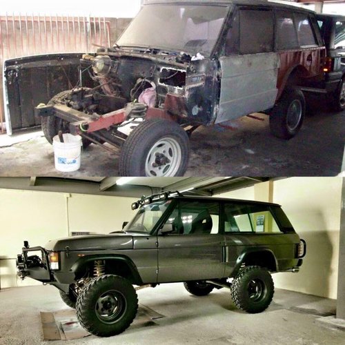

Remember this pre build...no comparison. Better than brand new.
