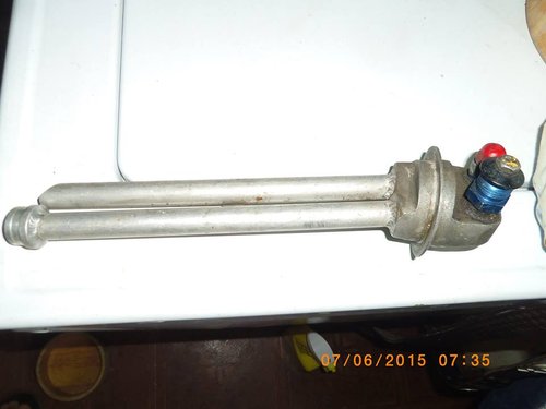

Only improvement I could see needed here is a PROPER fuel cell. That plastic outboard tank won't get past official rules...yuh done buildin everthing...so build one yourself! Ent?!
I have the pick up for an aluminum one...It's yours...
just go down to Marc One or Lifewear Mufflers and get a sheet of 1/4" alluminum sheeting, let Lifewear plasma cut the pieces, make sure put in a baffle and have someone TIG weld it together for you....lots of people I could suggest for you...maybe one guy I know would do it for free for you. But check to see if any of the race guys have one they took out...might be cheaper that way. Maybe.
