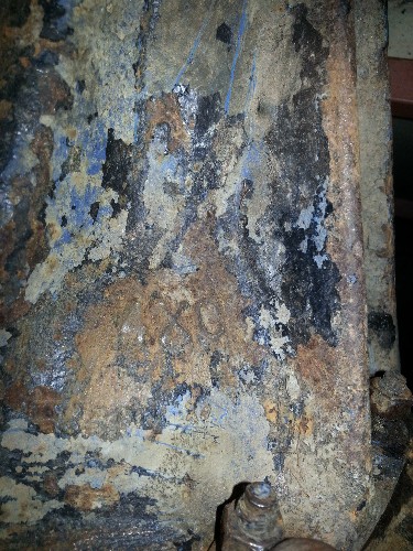

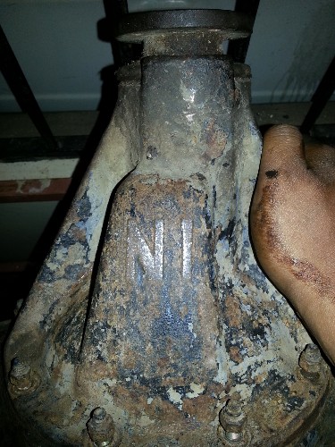

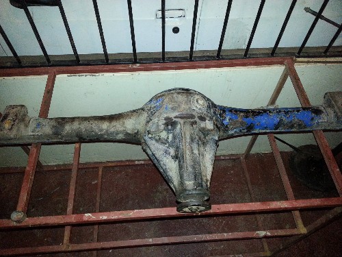

Well i have a diff, the guy igot it from said it's a 720.
Having a little trouble uploading the pics as the file is too big..
I did some looking on the diff for some indication as to what kind it is.
to the top of it has a big N 1 and I also found 4xc
cookiemonstar
Posts: 110
Joined: June 21st, 2012, 1:37 pm
Re: Datsun 720 rear diff disc brakes conversion - help
Postby cookiemonstar » May 22nd, 2015, 10:34 pm
Idk if that's enough to figure out what kind of diff Iit is
Postby Ted_v2 » May 22nd, 2015, 10:38 pm
Seems like a 720 diff. How you converting back to 4 hole tho?

Bezman
Posts: 6635
Postby Bezman » May 24th, 2015, 1:35 am
you should just buy this galant diff from this guy (if he hasnt sold already)
viewtopic.php?f=6&t=618320&hilit=lsd
if not, get a fabricator to make a jig for your diff so he can cut off your mounts and then weld them onto the new 720 diff.. you need ot make sure to get the right pinion angles otherwise you'ld buss ya diff or driveshaft
updated below
you can use the LSD's (guts) from the R200 diff from the S13/S14/S14, so that means the stock viscous lsd works and all the aftermarket ones..
EDIT
looking at your diff again, you have the same diff as the 910 blue bird or the H190 diff, think you can use the R180 guts from the ca18 S13's and older model subarus
