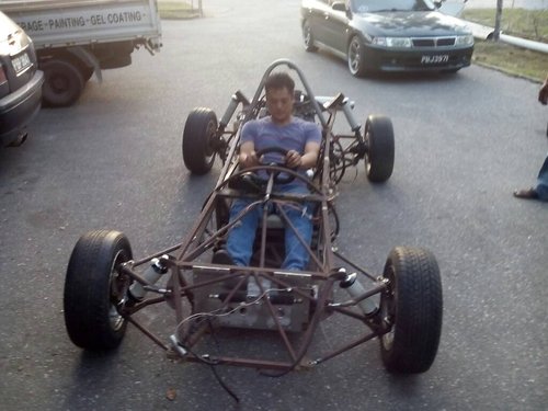

Things to make you go hmmmm.

CK Lancer looking good.

local CK? Looks well kept

dem shocks look real stiff tho

question: why was square section steel used instead of circular hollow section?
Posts: 23908
Re: Something Wicked This Way Comes
Postby MG Man » May 9th, 2015, 12:50 pm
most tube frame cars use square tubing....easier to cut and join

cacasplat3 wrote:question: why was square section steel used instead of circular hollow section?
This car was originally built in 1972 out of 7/8 inch hollow section and as MG Man says, it is easier to cut and join square section tubing.
MG Man wrote:most tube frame cars use square tubing....easier to cut and join
That being said, If I had to build a new one from scratch I would use round tubing because we now have the benders and notching tools. We can now make the main frame rails from one piece of tubing.
Ted_v2 wrote:Who building these locally?
With the exception of the frame, all other aspects of this car was engineered by Red Dawg Racing and built at Dow Fabrication. Although we can simply copy this frame we do hope to soon have a copy of the original blueprints.
racedriverpro wrote:Bedroom slippers
MOST CERTAINLY NOT.

What formula specification is the car being built to?

Postby Red Dawg » May 14th, 2015, 9:16 am
Rory Phoulorie wrote:What formula specification is the car being built to?
The car was originally built in 1973 to compete in the Caribbean Formula Championship.
We havent really deviated from that design. It was originally designed in England back in the 1960s as a sprint and hill climb car and does not really subscribe to any of the set "Formulas".

Here is our car, as it looked back in 1974...

Hi Red Dawg how yuh goin. Nice to see the project back on stream again.
What power unit? Ol' school 1275 Cooper... or something newer?
BTW what ever happened to the ex-Tom Miller Terrapin from the same era?
IIRC he bought an alloy (4-valve?) head for the engine back in the day. Who has that setup now?
