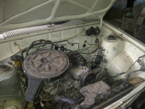

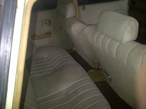

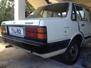

So back in 05 my car at the time (PAU 582) had an unfortunate disagreement with a light pole...of course you can guess who came out on top. From that time I had always wanted to rebuild the car but never found a shell that was worth putting the time and $$ into....that is until now. About a year ago I found a gem that was locked away in a cave for the last seven years and promptly persuaded the owner it was time to part with her. Having discovered from the forums that the AE86 was almost bolt for bolt and there was an abundance of parts available that would improve the handling and braking capabilities, my brother and I agreed that we would not make the same mistakes of old (lack of suspension and brakes) and started collecting the bits and pieces we needed to do this thing right. So we put together the following over the last year:
Blitz 32 way fully adjustable coilovers (with spindles)
J2 Adjustable Front & Rear Lateral Rods
J2 Adjustable Panhard Bar
J2 Adjustable Tension Rods
Complete Trueno GTS Rear End with ebrake
T3 Front LCA's, RCA's and Traction Brackets
Prothane Sway bar end links
Godspeed 25mm front sway bar
Polyurethene Steering rack bushings
Willwood 300mm front Rotors with customs aluminum hats and big brake brackets
Brembo Front Rotors

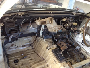

Started on getting the car scrapped to a bare chassis to see what repairs will need to be done
Inside Gutted, floor pan looks really good
Car is in its resting place for the next couple of months
Engine is out

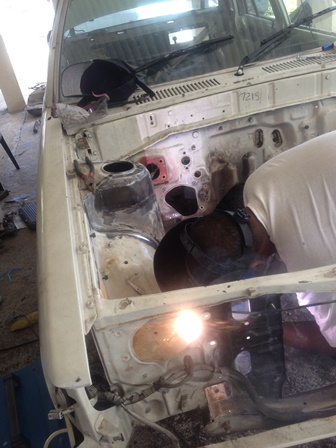

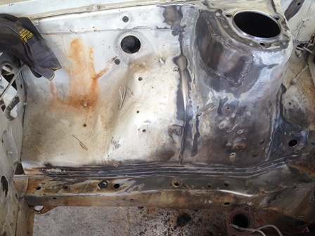

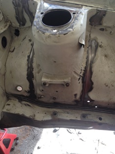

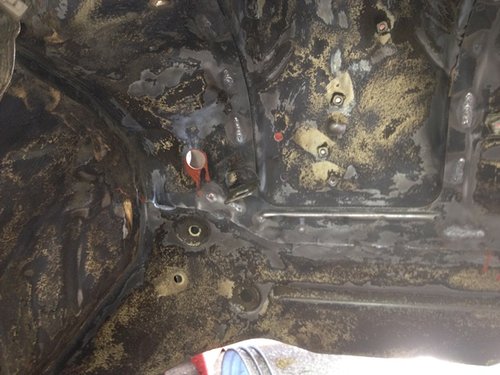

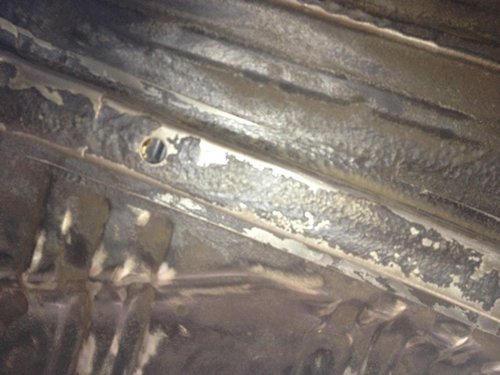

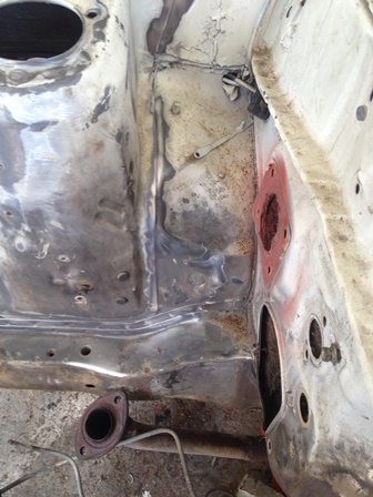

Started prepping the engine bay for some stitch welds, had issues in the past with twisting so looking for that extra rigidity to handle the torque. This chassis was originally designed for 82hp so need to make sure that we make it strong enough to cope with a boosted engine
Not 100% happy with the job but....
taking off the original seam sealant was relatively easy with a hand grinder and wire brush
more prep for welding

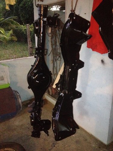

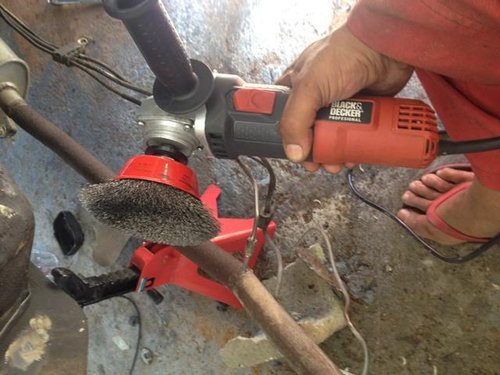

Started power brushing the undercarriage and other bits in preparation for refinish, want it to look as clean as possible when we put it all together
My best friend at the moment

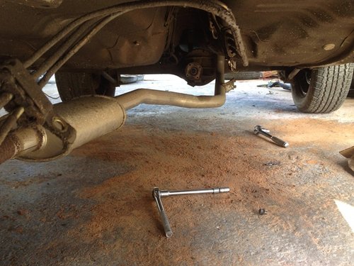

Still to remove the exhaust and fuel/brake lines
Fender arch buffed
banjo buffed and ready for paint
cross member buffed and ready for paint
finished product
