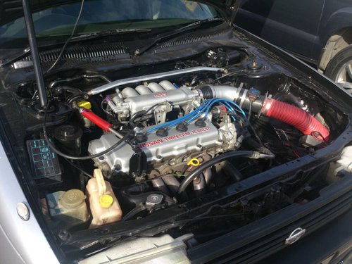

Well fellas, Yodins have a car now. Ga16 de b13. Want to turbo it. Any of Allyuh know who could help wrt sourcing parts/tuning etc.
Any advice/pointers/opinions will be appreciated.
And stop with that "juss puh een a sr nah" talk. If we wanted to go sr we would go sr.

Looking at the engine it looks like Richard's b13.If you are serious im goin to scrap my buddy b12 Ga16DET back to de as he is selling the car.Pm me if you are interested.

How much power do you want and how much do you have to spend?

Most people will say SR because the cost to turbo a GA or QG cost quite a lot and the gains are little. A stock SR20 NA will still issue a dread cut arse on them.

I know a guy did this on his taxi ran for 2 years no problem
10lbs
stock everything
logstyle manifold 2000
stock sr/ca t25 turbo 1000
intercooler and piping 3000
exhaust work 1500
BOV 1000
Gauges - 1500
Total 10000
To do the swap
sr20 - 4000-10000
90% of det men swap for t28 turbo - 3500
exhaust work 1500
bov 1500
gauges 1500
Wiring/relays/fusebox 1500
total 16500 - 22500
both prices excluding mechanic's labour cost
I would personally turbo the ga
the fwd sr men eh sayin nothing - plus lsd gearbox etc not making sense to me as that is an additional 3500

I turboed Ga16/Qg18 already water/Meth Greddy emanage 12psi of boost an stock Sr20DET"s is get a run for for their money.

TurboSingh12 wrote:Looking at the engine it looks like Richard's b13.If you are serious im goin to scrap my buddy b12 Ga16DET back to de as he is selling the car.Pm me if you are interested.
Correct is right.
VexXx Dogg wrote:How much power do you want and how much do you have to spend?
About 10k. Looking at about 150hp or around that vicinity.
Yuh see, cheaper, less hassle wrt looking for engine etc. But what was that about the lsd diff? That was for the ga or the sr?
And how much for a water meth kit?

Then consider ease of finding parts for a GA16, I understand they kind of hard to find parts for. If you blow up something chances are you might be left on sh!t street and end up buying an SR20 anyways.
Stock NA SR was within the $5k region last I checked. Yes everyone has an SR20 this rounds but is a set of half dead ones it have all over, QG16 putting cut ass on them without breaking a sweat. A properly working SR20 is real pace!!!!
Boosted GA16 might drink some gas when it hits boost depending on the turbo you using too if I am correct.
not trying to deter you, just letting you know what you getting into before you do.

I wah be diff. A leader not a follower. Nameen? But thanks and I know it'll be a gas guzzler when it tuned an thing but might still consume less than the 2l.

Postby Ted_v2 » January 18th, 2015, 9:35 am
Easy as turbosingh said.
u need a emanage to handle the turbo and the tuning.
water meth to keep it cool.
a small t25/28/td04wrx.
i saw some prices posted above and its alot, you can keep this cheap and economical. Buy used parts. most parts on the market now are very expensive. buy used when you can but make sure to check it out first.
A mitsu evo intercooler goings for around 600$ used.
boost gauge from 350-500.
a emanage selling on the forum right now for around 2500$, the synticate, He is a good person when it comes to turbo'in engines. His stuff bess.
i believe ur car already has 2.5 exhaust not so? thats pretty boost friendly.
Finally get a good mechanic, From when i spoke to you . thats what u need.

Well fellas so far I get a couple offers but one man to expensive and the next man too far lol. As Ted said I go buy parts used and one by one.
I eh know what is a e manage tho.
Look a list of the things the car has
Ga16de vtc engine and gearbox, full 2" exhaust and extractors, rsr barrel, apexi safc neo management, custom cold air intake with k&n filter, Kenwood deck, pair of pioneer 6x9 and 2 6" door speakers, battery relocated to the trunk, hids in headlights, sr20 vvl air flow, auto gauge tach, oil pressure gauge, autometer af gauge, autometer egt gauge...

U could use the safc instead of the emange as you already have it!

bump. turbosingh padna have some good stuff but too far and idk if he go meet me halfway or something because i eh know sheit bout down there.
maniflod $500, tial external wastegate $1000, bov $250, turbo and downpipe $1500, intercooler and piping $500, vvl injectors $200, braided oil line $600.
sounds decent right?

Everything sounding good from what you posted.
Nice deals once everything legit
